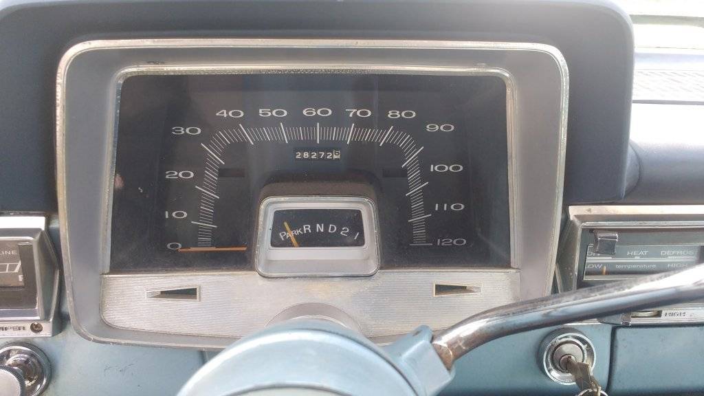

I live up in Canada where the speed limits are all in kilometers instead of miles. My 65 Savoy speedometer is in miles. I am terrible at judging my speed and need to rely on the speedometer. Its one thing to go with the flow of traffic but when there are minimal/no cars around I could be doing 100 in an 80 and I wouldnt notice.
I've been told that these old speedometers are very inaccurate to begin with so I was thinking about driving next to a friend with a new car, have him yell out the actual speed, compare it to my speedometer and record it. then make sticky notes with the correct speed in metric. This however will look really messy and definitely wont last. I'd much rather have the change made mechanically. Can anyone tell me if it is possible? Again, I am referring to my 1965 Plymouth Savoy (Fury).

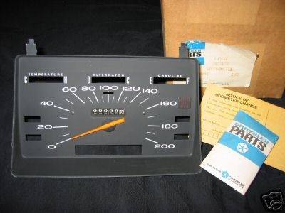

Back in the day when metric hit Canada, the solution was a sheet of red stickon dots, in various colors and about 1/4" in diameter. You just stuck them on the speedo cover plastic. The worked, but weren't pretty. To day search eBay for mph to kph stickers and you'll find a pile of them. You can stick them on the cover or open the speedo and actually make your own custom gauge face. I cheated on my Fury, I bought a metric speedometer from a European Mopar.

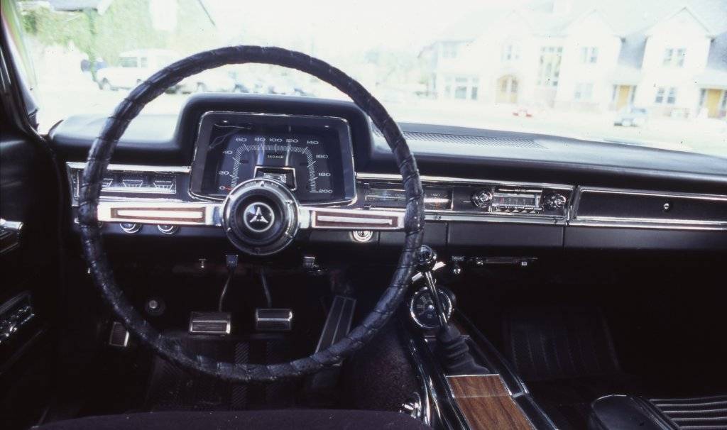

Being Canadian too I have Kilo speedos sourced from Europe (Finland and Norway) in both my cars too (66 Monaco which in Canada yses Fury dash and speedo and 66 Chrysler T&C) - they're out there but hard to find.
Bill is a copycat as I had mine first
I even converted my T&C Autopilot dial to KMs - and just finished making a custom KM dial for my Monaco Autopilot - a long story for another thread.
