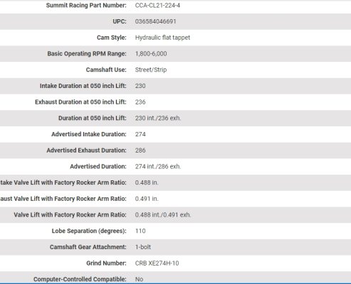

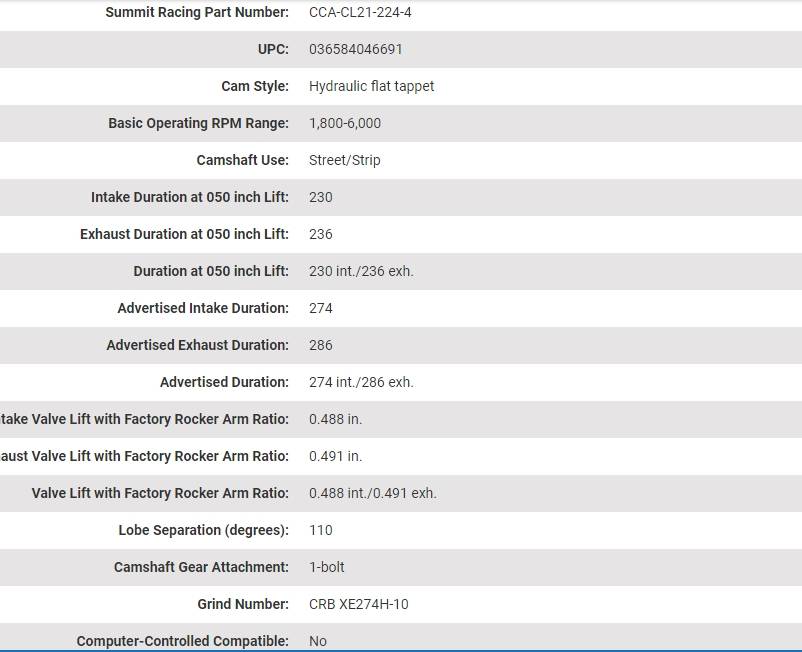

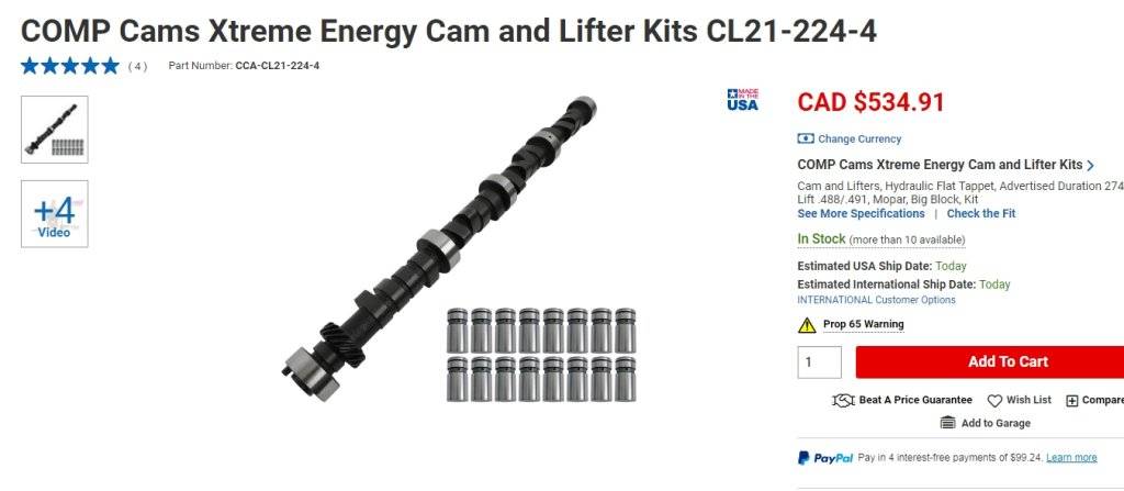

I was thinking of using this cam CL21-224-4 with the stealth heads.
I dont want to have interference problems with the L2315 flat top pistons.
The shop said I'll be ok but I need to verify everything.
Comp says 68 and up because different lifters. I read here if I go with the matching push rods I'll be ok. Is that 100%?

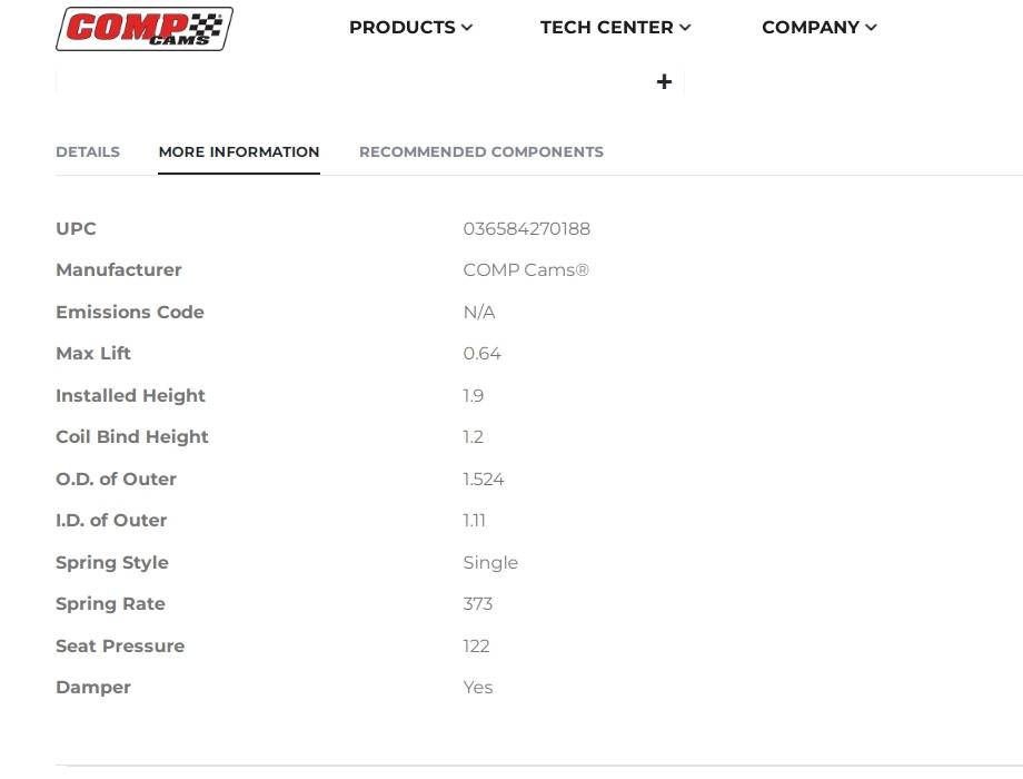

Comp suggests these springs for the cam: COMP Cams Valve Springs 911-16

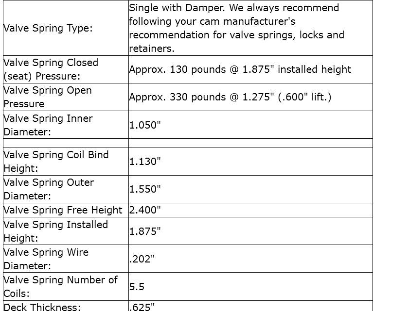

Stealth list their spring pretty close:
Anyone care to help me choose I'm starting to get a bit overwhelmed.

Cam selection -- The part that might be an issue is the gross valve lift. Use the valve lift of the old, original Chrysler Purple Shaft 284/284 cam as a guide. Might back-down the lift a bit with similar duration. There's also a Lunati cam that some in here have used in there 383/325 engines with no problems. It's more like a modern version of the Chrysler 383/440 HP cam. No issues with piston clearance. It might be a good option, too. Summit sells it as "their brand" at a good price.

In general, valve spring pressures need to be "just enough" to get things done for the lift of the cam and rpm range. Heavier is good, to a point, especially on a flat tappet lifter. Roller lifters, not so much. Like the insurance commercial touts, get only what you need.
'67 and down used a different lifter and a push rod to match. The push rods are smaller on one end.
Last I knew, the early lifters aren't readily available, so it's a moot point.
The later lifters will work as long as you use the correct, later push rods.
