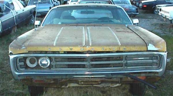

Canadian 71 sport fury GT
Little update; still looking for the drip rails.
You have misplaced the drip rails or your
Looking for some? I have some on 70 300 coupe if they interchange?
BTW nice work on the GT

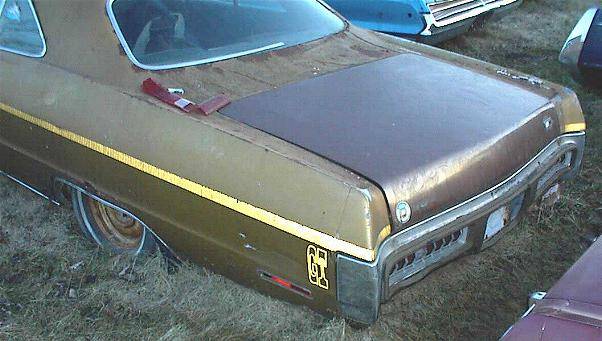

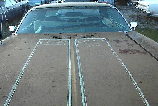

Lol The year was 2001 and I was searching for a mopar car I came across this one listed and I had never seen a GT before! I think he was asking 2200 , I ended up getting 3 chrysler hurst cars for the same price

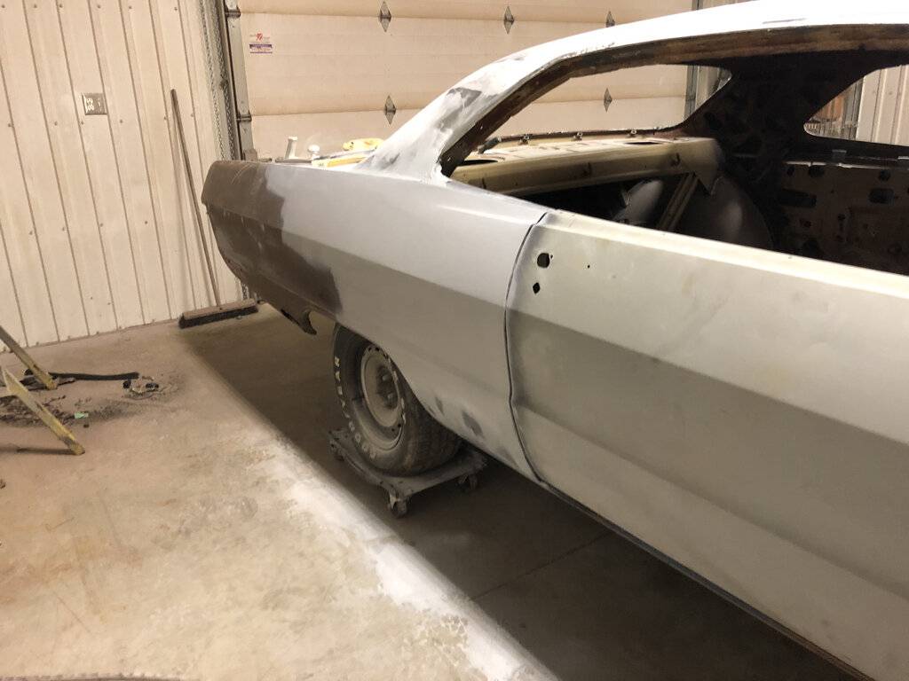

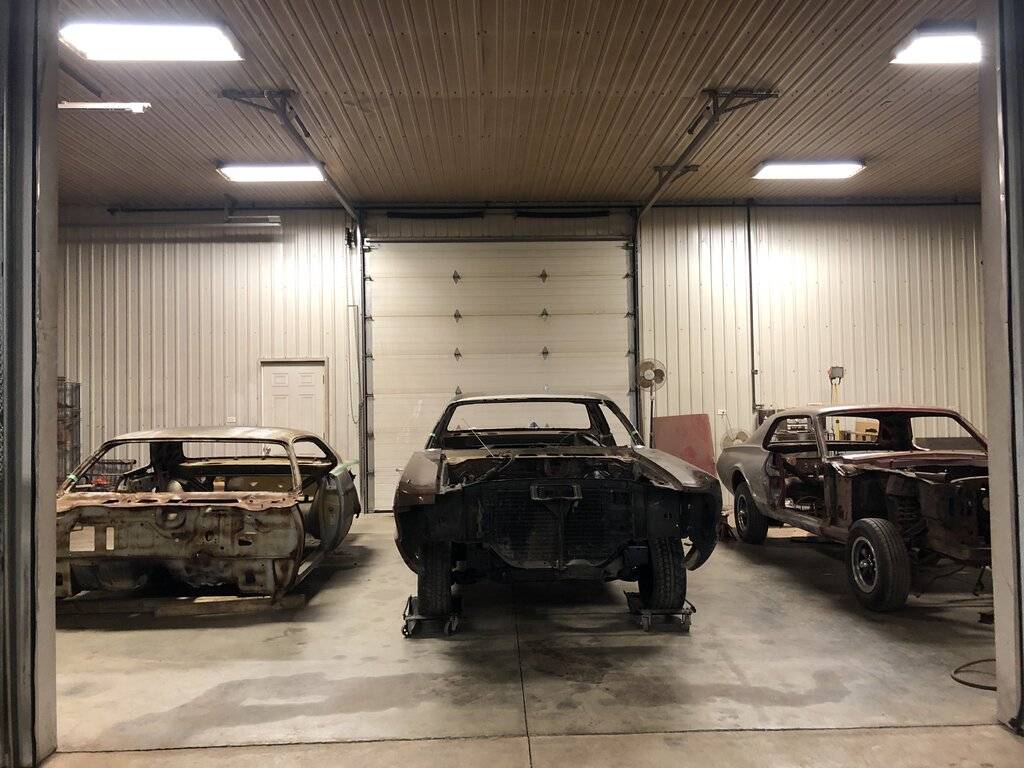

Barely any over the past few months. I spent some time building a new shop and picking up some easy projects in between while I find parts for the GT, life and some reoccurring health issues slowed me down for a bit but I have almost everything I need now for the car and should be moving it to the new shop this weekend hopefully.

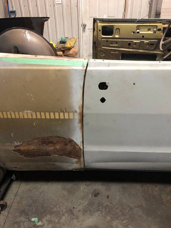

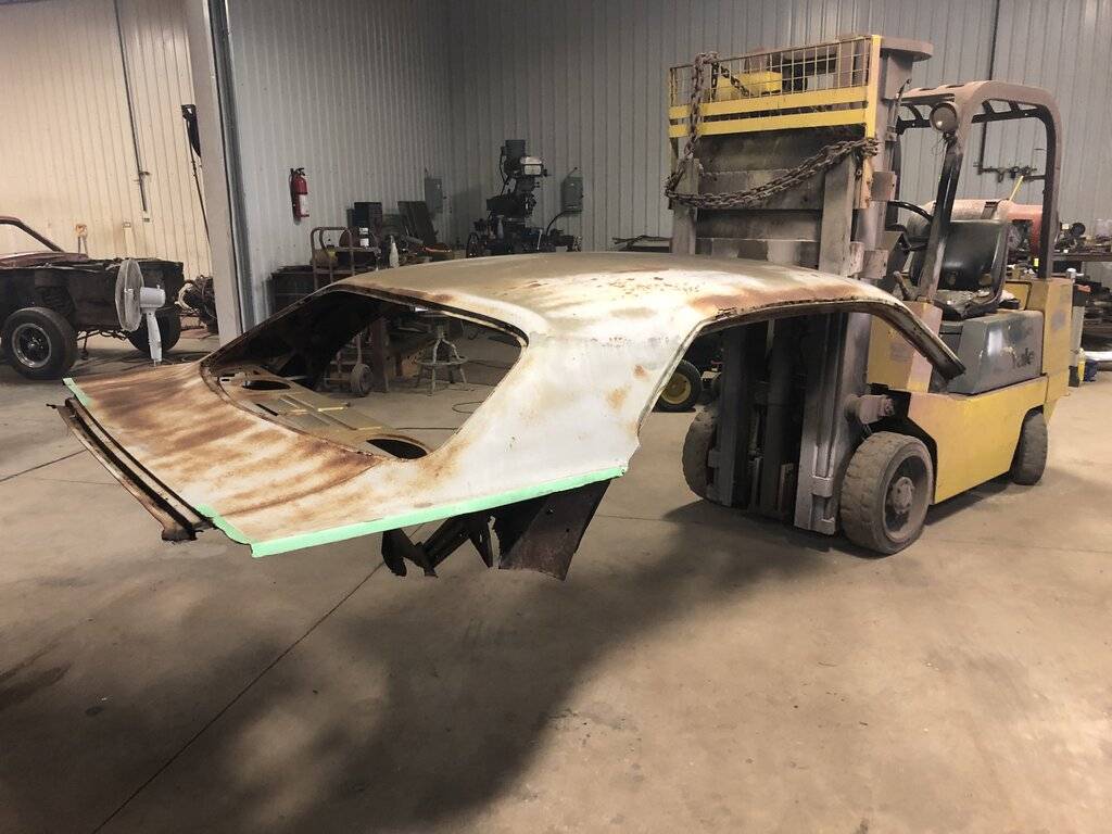

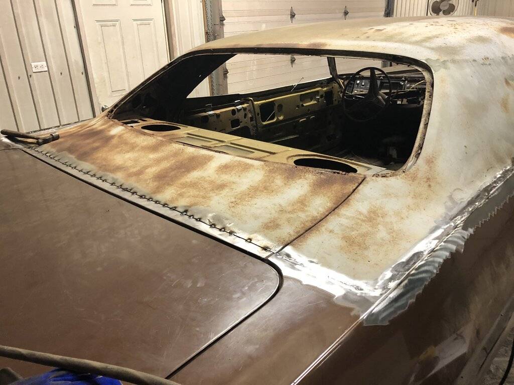

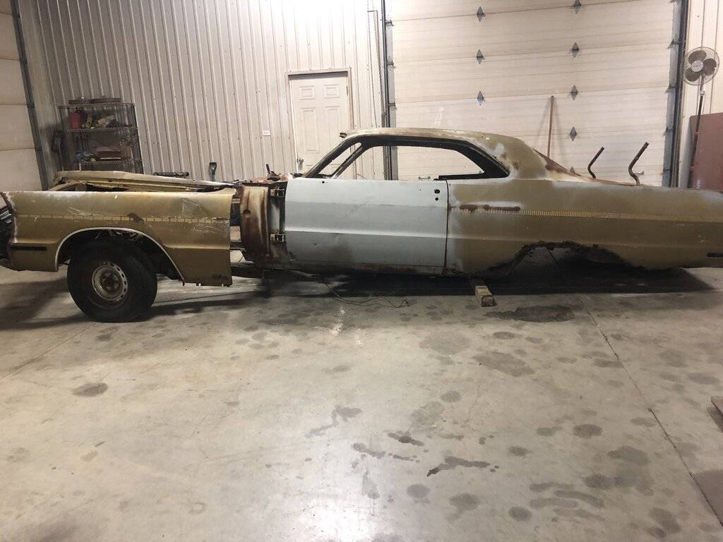

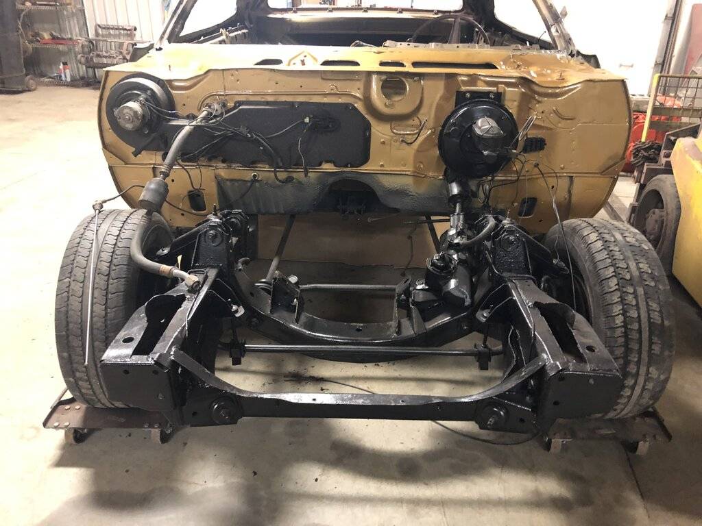

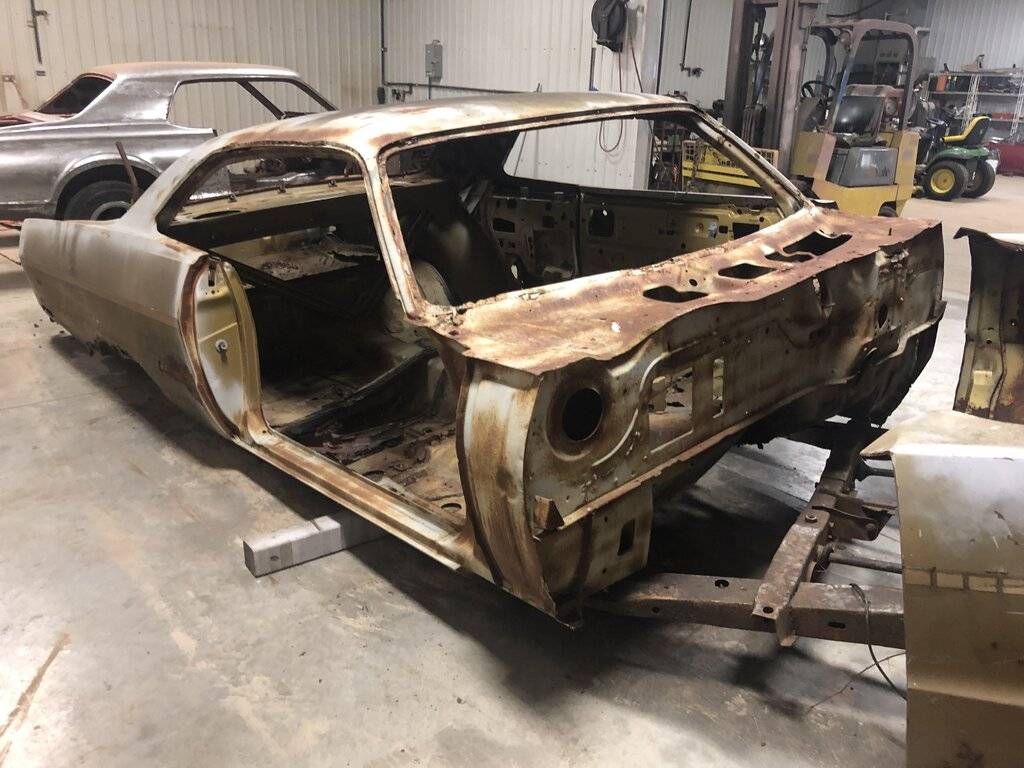

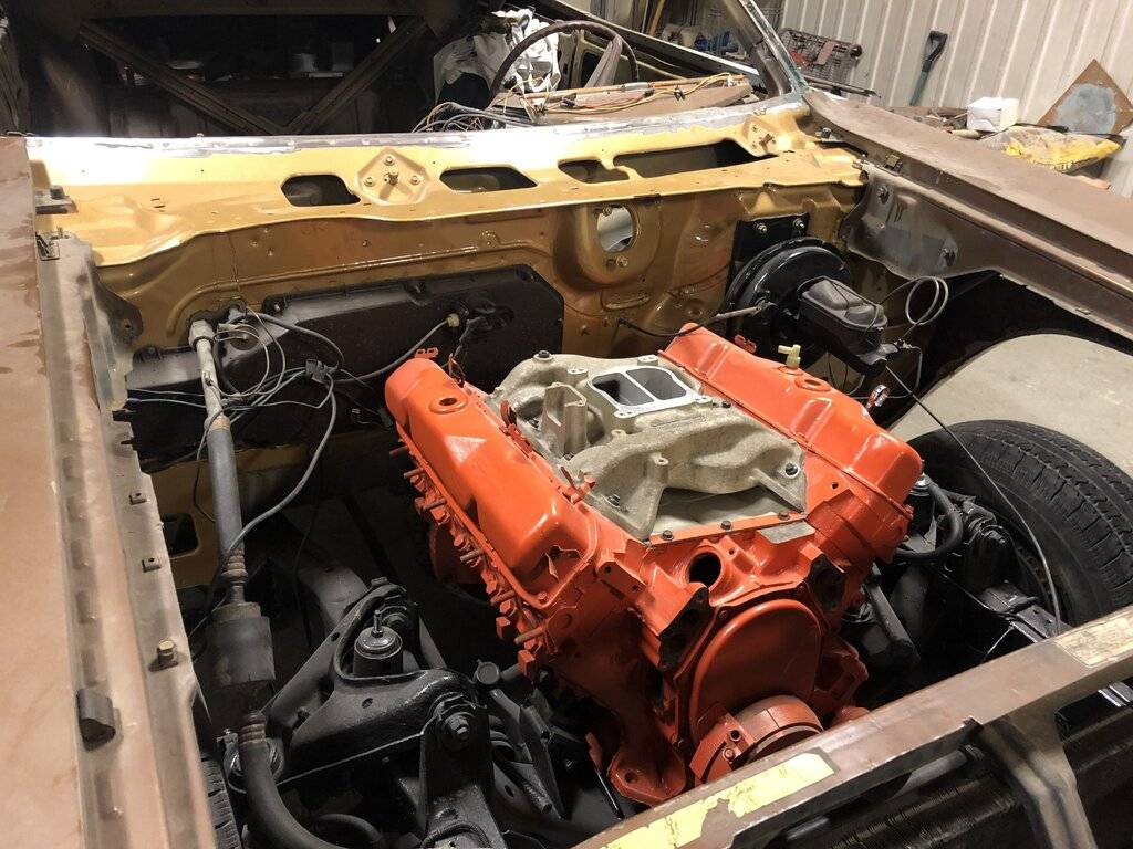

I don’t get to post on here very often but recently I picked up a car I’ve been after for some time and I spent the last 4 weeks working on it. This is a 1971 Plymouth sport fury GT Canadian car, gold with green interior. Although it may never be original again it will for sure be on the road again soon with help from a 4 door donor vehicle.
I saved as much as possible from the GT tub, doors, roof, entire interior, all the interior panels and supports... cut the roof and all 4 door components from the donor car and transferred all parts from the GT. The majority or steel work is done aside from a few patches here and there but overall I’m pleased with the progress made on the car. Ok decided to respray the car gold and the only thing I will be changing appearance wise will be the strobe stripes from gold to black.

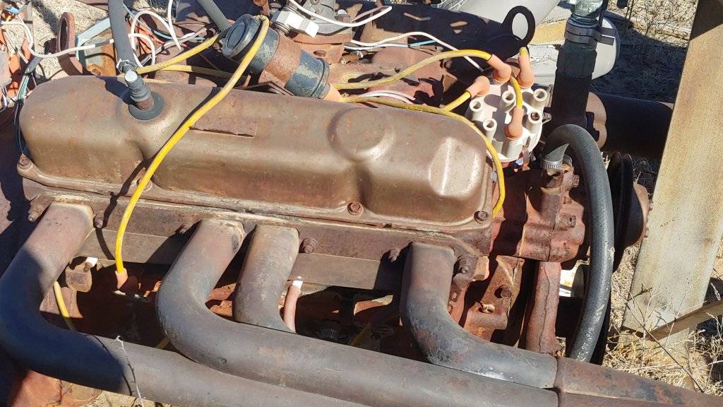

What are those valve covers from, I've never seen then with the horizontal area for the oil separators.
Late 70s Industrial engine?
