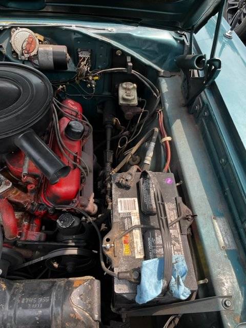

From the searches I've done, the base looks like it might be period correct, the mast is definately modern and it's off kilter, the base needs adjusted. I hope to find the build sheet next weekend and I'll try to get a better pic of the antenna, until then, you can see it in the top right of this pic.
I believe the car did not come with a radio, still haven't looked for a build sheet yet. There is a radio block off plate in the glove box so I'm guessing one of the previous two owners added the radio and hacked up the antenna installation.

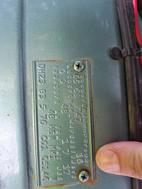

On your fender tag, under the lower case "w" if Cdn Spec'd it will read 6
U.S. spec'd cars will read an 8.
My tag 67 Monaco 500, Windsor built, Canadian spec.

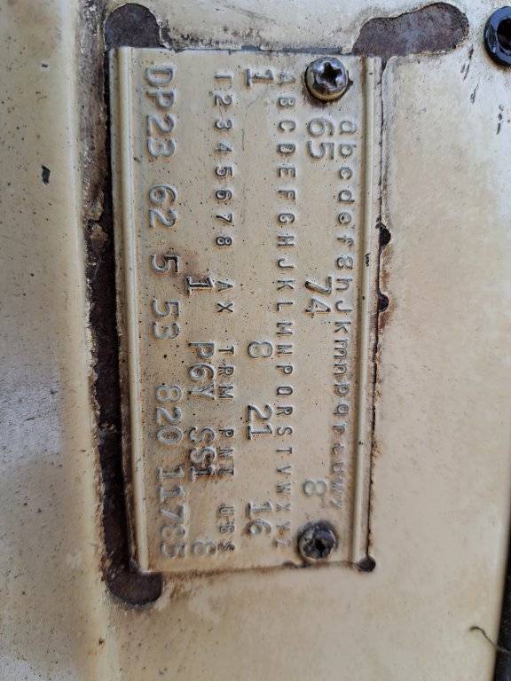

Second photo is another Monaco 500 Windsor built but Spec'd and sold in Michigan, USA
Different plants coded differently. The two digit tire code tells us the cars were built at the Windsor plant and you confirmed that. Windsor plant did use the w/6 and w/8 coding.
A 67 Coronet (different plant) bound for Canada will code w/6. A US spec car will not code w/8.

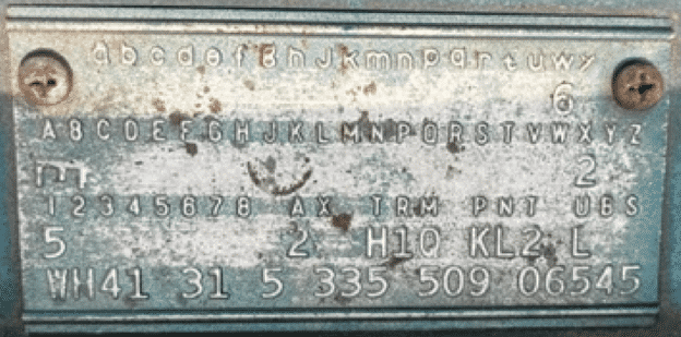

My decoding effort of the fender tag.
Line 1&2:
Code w – 6 = Built to Canadian Specifications
Line 3&4:
Code X – 2 = Tinted Windshield Only
Line 5&6:
Code 1 – 5 = Drip Rail Molding
Code AX – 2 = 2.94 Axle Ratio
Code TRM – H1Q = Dark Turquoise Interior
Code PNT – KL2 = Two Tone Paint, Medium Turquoise Roof, Dark Turquoise Body
Code U – L = Dark Turquoise Upper Door Frame
Line 7:
Code W = Dodge Coronet
Code H = Coronet 440
Code 4 = 4 Door
Code 1 = Sedan
Code 31 = 273, 2bbl V8
Code 5 = 3sp Automatic
Code 33 = 7.35x14 Whitewall Tires
Code 5 = Spare Tire, same as other 4.
Code 5 = Scheduled Production Month, May 1967
Code 09 = Scheduled Production Day, 9th
Code 06545 = Shipping/Order Number
