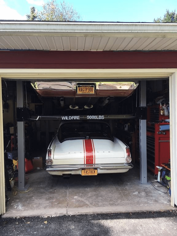

I have a 4 post lift and and the lowest point of the ceiling over my lift is under 10'.
For me, it's great... The biggest issue is the garage door as I don't have that much height with the door open.
I can lift it far enough that I can park another car underneath, although it's tight. For working, I have a couple rolling stools to sit on if I can't get the car quite high enough.
I have a rolling jack support that came with the lift, but the jack itself wasn't in the budget at the time, so instead I bought a pneumatic "air bag" jack that works fantastic. I can either use the support or even the ramp itself to jack the car up for suspension or brake work. I have a bottle jack that I've used too.
Jack: VEVOR Triple Bag Air Jack, 3 Ton (6600 lbs) Capacity, Portable Pneumatic Car Jacks, Fast Lifting up to 16 Inch Height, Heavy Duty & Quick Lifting for Garage Car Repair, Red | VEVOR US
I bought the lift from these guys because I felt their latching system was more robust and failsafe. Their main website appears to be down at the moment, but here's the Facebook page for them. Wildfire Lifts
EDIT: Their webpage is back up. 4 Post Car Lifts | Safest, Highest Quality On The Market | Four Post
I have 10'-4" ceilings and it is very tight for two B Bodies, but works. I use it mainly for storage. I do have the trolley jack for doing brakes and can also do transmission and center section swaps easily up on it as well.

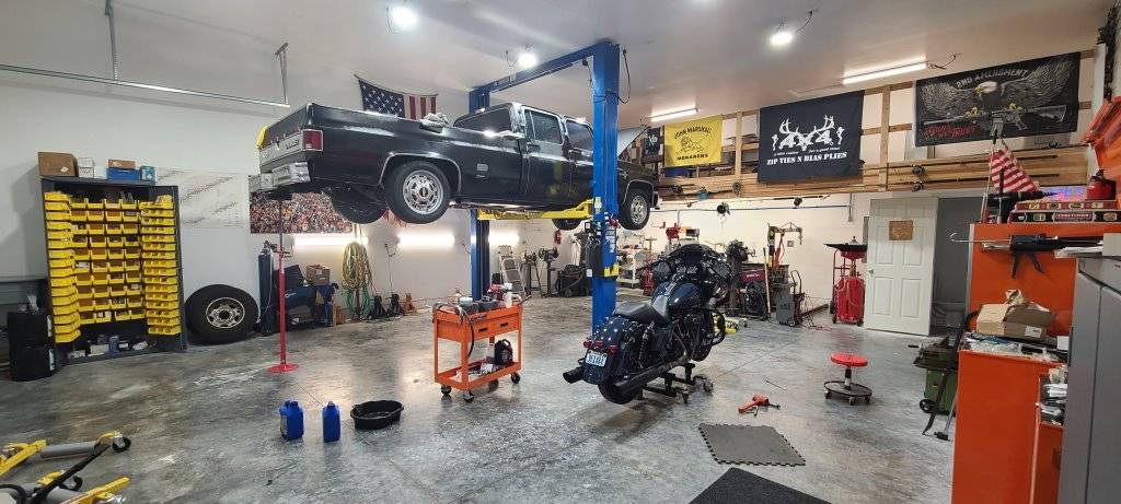

There's a Dover 2 post liftnear me for sale I'm interested in. It would get the car and me off the ground even though I don't have the height. A friend of mine is an architect engineer, he redesigned the trusses for another friend so he could put a lift in his 10' shop. Comes with a manual tire removal machine too.
@Mr onetwo , in this photo it looks like both vertical posts are leaning inwards? Just curious, it sort of appears the hold-down bolts to the floor aren't tight or ?? If this wasn't planned, I'd hate to see how this would shake out if the posts didn't stay put.
That would be the camera's perspective. ( I think that's the correct term). The focus is on the car and not the lift. Note the shelves in the background also appear to lean in at the top.
Just the camera....that photo was taken with an old Canon digital, not my newer iPhone. The bottom plates are 5/8 in thick and are attached to 3/4-10 x 6 1/2" epoxy anchors rated at 46,000 lbs tensile strength each.I assure you that those posts aren't going anywhere.
