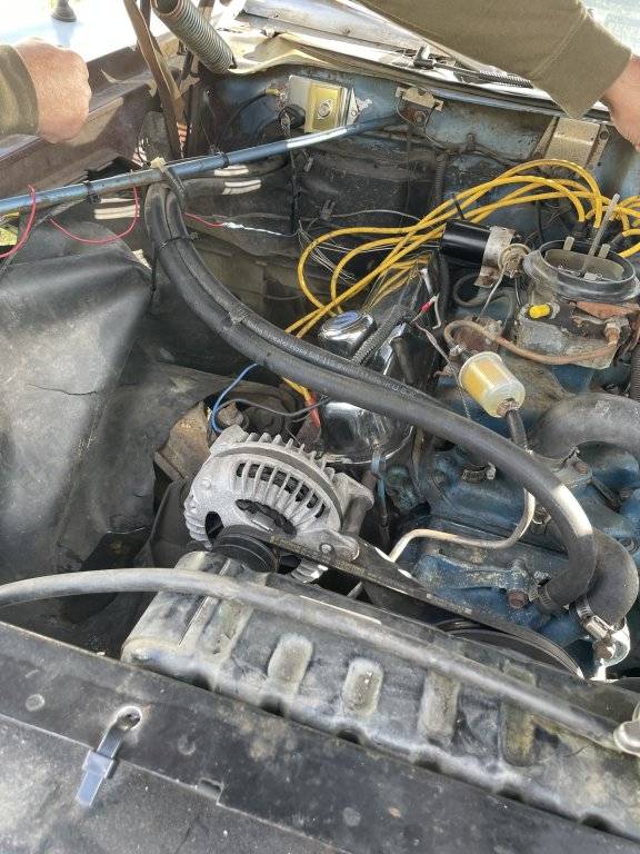

It’s got aftermarket electronic ignition. See where it’s cracked right by the arm, well we moved that little box to a more grounded place on the engine. We are tackling the problems slowly one day at a time and hope we are getting closer

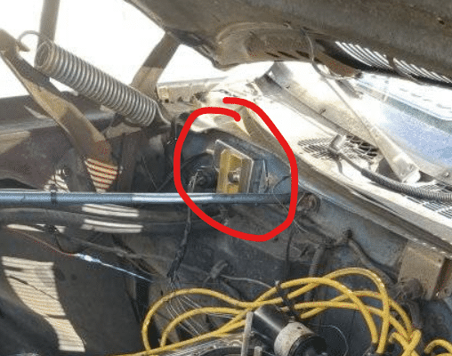

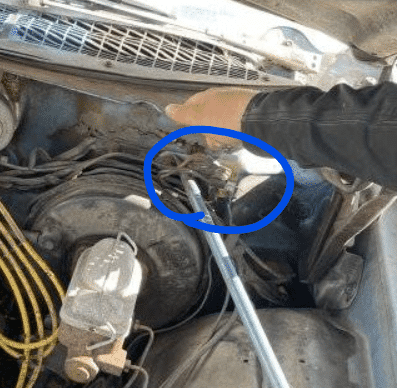

Good pictures. Yes, it has electronic ignition, but I have a follow up question. The little box you mentioned, is it the one circled in red or the one circled in blue?
The ECU is circled in red. The other one looks like a starter relay.

So the ecu is brand new, the starter relay wasn’t cracked it was on a bad part of the firewall so we moved it. As we eliminate problems we are now down to it’s probably just a bad ground, but where is what we don’t know
Starter relay position shouldn't matter, as long as the engine cranks it's good.
If you suspect a bad ground it can pretty much only be a bad ground on the ECU. If you have a couple length of wire you could connect the ECU directly with the negatieve post of the battery.
