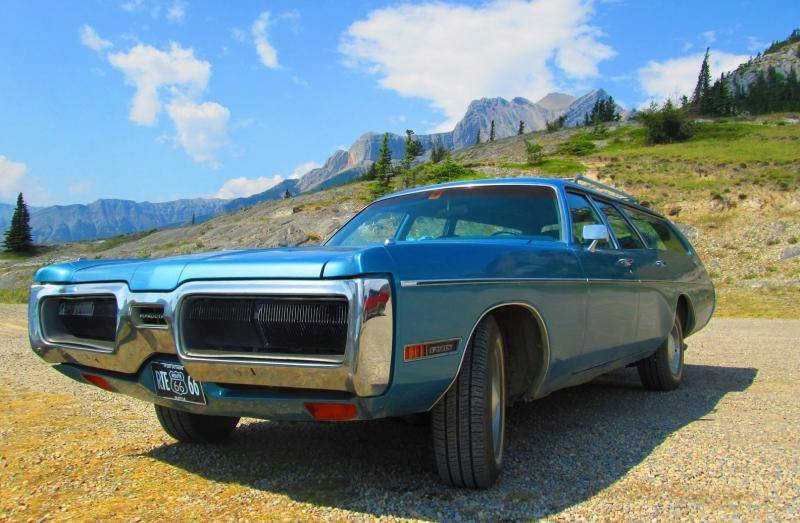

Was away from the computer for a while, thanks for all the help, I did get it figured out; replaced the relay on the firewall and it didn't help.
Then I remembered that I did have a problem once with the bulkhead connector on our `65 convertible, so I made sure the connections were good, one seemed to be loose so I cleaned it and connected it again, now nothing at all, looked underneath and found the neutral safety switch had come undone ( last time we drove the car for a one nite tenting trip in the Rockies, we drove through some 6 inches of hail slush on the highway, must have caused the switch to come loose). I plugged the switch back in, and it`s back to normal, car has been running flawless ever since.
Thanks to ya`ll again, Marty
