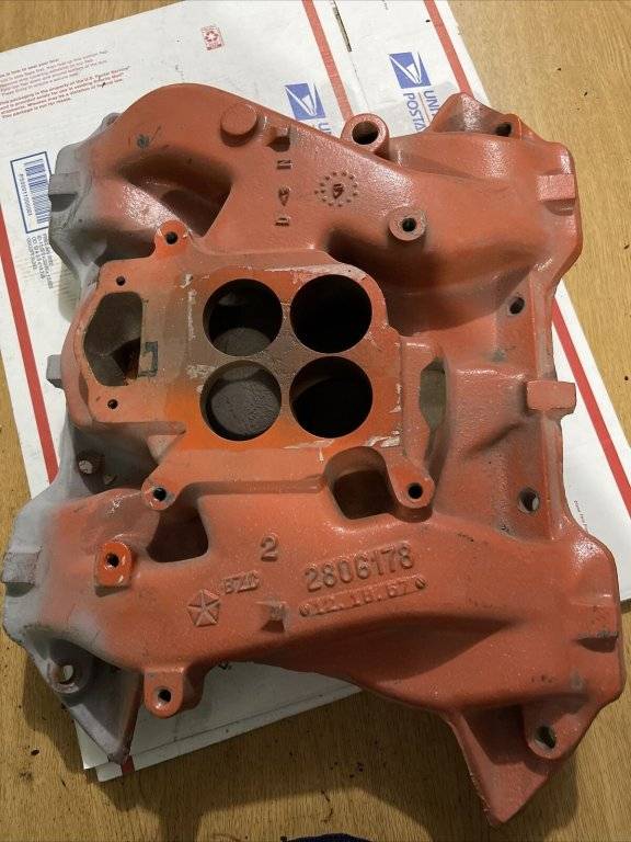

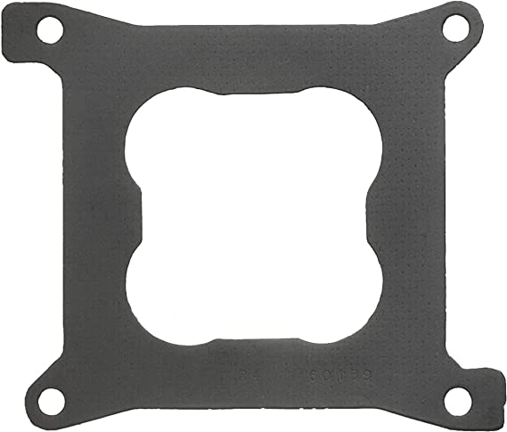

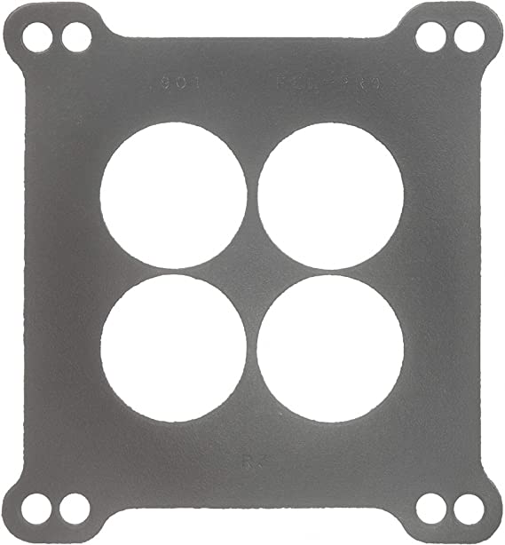

ok, so I have a 1968 New Yorker. I need to know which type of gasket to use for the carb. Common sense would tell you to use the 4 hole gasket. Every time I try to order this gasket from anywhere its telling me to order the open plenum gasket. so any help would be appreciated. Pictures attached...

The open plenum gasket will be fine. Consider getting a thicker gasket/spacer if you have the hood clearance as it will help reduce vapor lock conditions.

thanks everyone for the feed back. I think I'm going to go with the one that makes the most sense. If that one doesn't work I know now that the other one will. definitely going to get a spacer. Thanks again. just trying to make it a daily driver.

HOLLEY 108-12 is the open plenum thick gasket with 4 studs and nuts.
HOLLEY 108-18 is the thick gasket, divided down the middle, with metal inserts in the carb stud holes, which was OEM on my '70 Monaco 383 4bbl AVS.
EDELBROCK 9266 is the thick divided plenum gasket with metal inserts in the carb stud holes, with 4 studs.
EDELBROCK 9265 is the thick open plenum gasket with plastic inserts in the carb stud holes, with 4 studs.
EDELBROCK 12410 is the open plenum gasket with 4 studs.
Enjoy!
CBODY67
1969 amd older used the thin gaskets. Ive been using these mr gasket 55C for decades with zero trouble. Install them clean and dry.
The thick gaskets with spacers started in 1970. You must use them or the Carter carb will hit the choke thermostat and not seal the carb base to the intake. They are so thick they will foul up the choke linkage Length On a 69 and older mopar.
