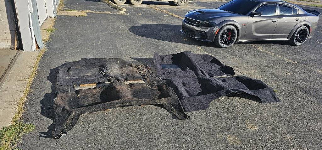

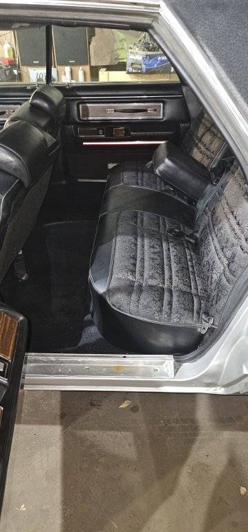

Well I've used ACC in the past on my 70 Polara vert, and I have some laying in the Servpro waiting for me to finish. Just this week I installed ACC in @ayilar 73 chrysler. It fit perfect with minimal trimming.
My pick is ACC...but I'm curious to hear others input as well.
And a couple tips I've learned. First, use an old soldering iron to make holes and don't do the final trim on the edges until you've bolted in the seats.

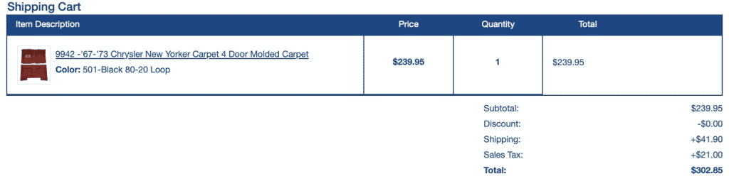

I ordered the carpet that @71Polara383 just installed into Ming, my 1973 NYB, from Stock Interiors. That decision was based on posts by @Big_John in a number of threads in the past 5 years, as I trust his judgement. Here is the order detail:

From this I gather you didn't get the extra mass backing nor additional sound dampening. Could either you or @71Polara383 eloborate on why not?
