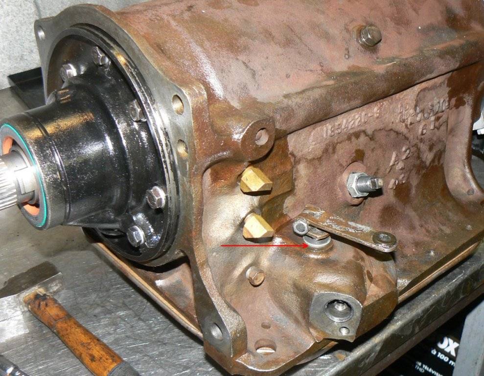

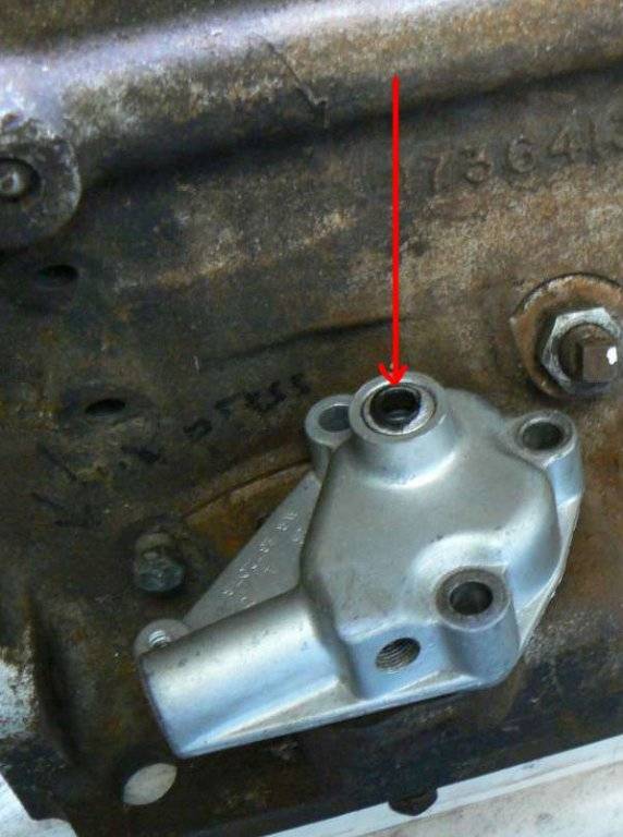

The Throttle lever is where my leak is as I mentioned in my original post. I call it the kick down lever but that is where my question lies.........Is it an O ring or a special seal? My service manual does not specifically mention this seal or a part number. Nor does the parts manual. It points to the seal but does not identify it. I plan on addressing the leak in the next few weeks but wanted to have the correct parts before I tackle the issue. I am beginning to believe it is just an O ring since most Oil seals have an actual part number. Since you have dealt with many of these transmissions, can you verify it is in fact an O ring? And is it accessed by dropping the pan and valve body?I know well the cast iron Torqueflite, i've overhauled 20 or 30 since 20 years. It can leak by the cable (o-ring seen on the message of Loadrunner) but also by the axle of the throttle lever. Under the throttle lever lever there's a small seal and it's often by this location that oil comes out of the transmission, especially when ther's a converter drain back (after some days or weeks)

Remove the throttle lever and lift the seal.
Perfect! Thank you Phil. That is what I was looking for. I found it in my parts book now thanks to you! Now I just need to find one that isn't gold plated. I don't need the external seal kit that Fatsco has since I have most of that kit already.I join two pics because the earlier transmlission (1956-58 1/2) have a different case that the later (59-61): the throttle lever / cable housing is removable on earlier and cast on the trans. case on later. You can see the seal , if i remember well it's not an o-ring, it is intalled on the housing and not on the axle of the throttle lever. I never replaced it on a trans. in a car, but i think you can do that without removing oil pan and valve body. Remove the throttle lever and lift the seal.

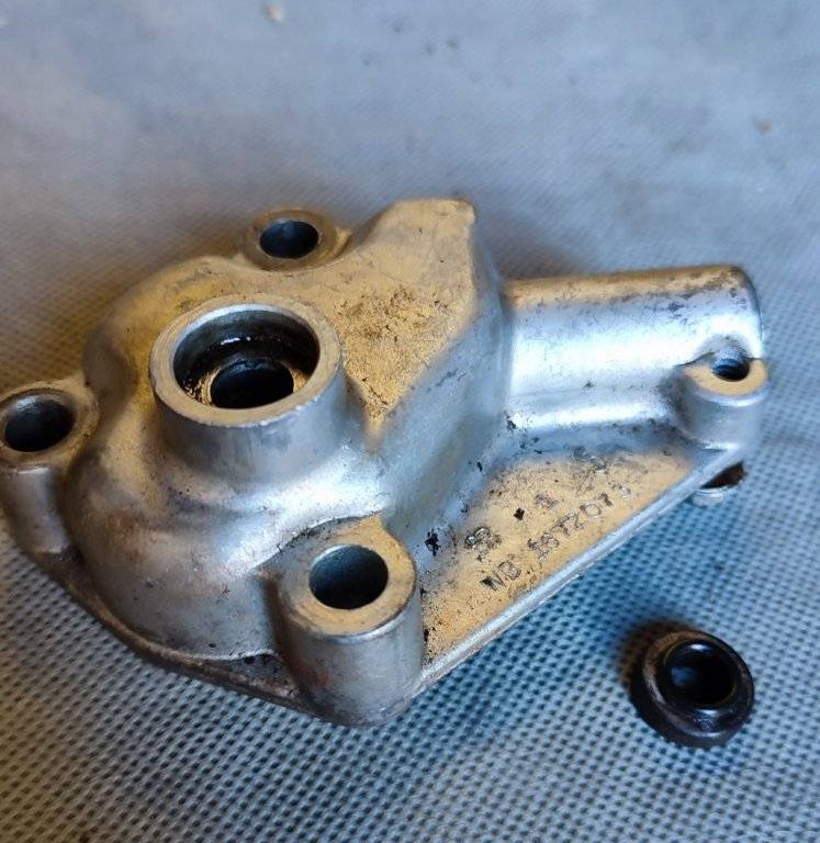

using and you can see itsn't an o-ring ...

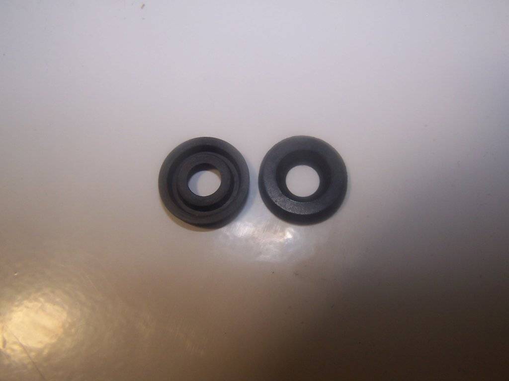

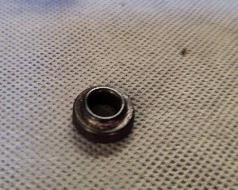

ORiellys huh? I gave them the Chrysler PN and they couldn't come up with any thing for that seal. I called Napa and they crossed the number to one they could get. I ordered it just to see how it compared to the one from Fatsco. I should have both of them this week to see how they compare. Did yours look like the pic in post #30?I got the seal from oriellys auto parts for about a dollar. You MUST make sure you have the old seals out. The seal just pushes in easy. Mine had two seals we got one out and thought it was the only one. Gave us fits. Once we got all the old seals out no leaks
Okay........I received both seals today. One from Fatsco and one from Napa. They both look the same but are different from the picture in post #30. Now my question is which way does it go in? Like a regular oil seal with the groove Up or down. I'm guessing the groove down. That puts the tapered end down like a regular oil seal.Yes that’s it. Sometimes you can get it out wit a pick. Ours was hard as a rock And could have been in there from the factory. I’ll reach out to another guy who might have better info. Your on the right track
