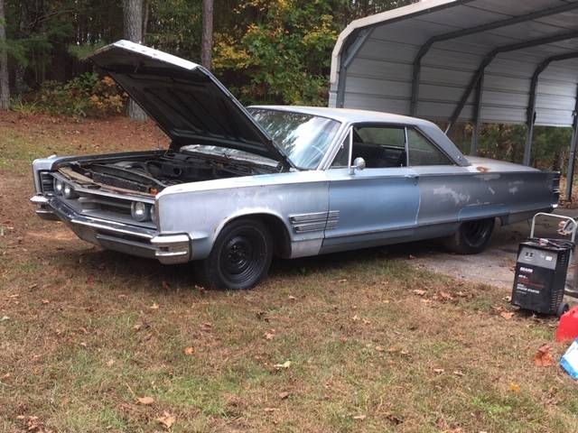

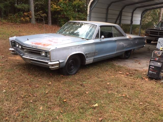

View attachment 227482 View attachment 227483 Hey look what I did today. I started her up. And drove down the yard to the shop. Basically just let it run & shifted the trans a bit. Driver door is sticking so worked on that some. Better but not right still.
It’s blue.Has this been blue or grey?
I bought a reman distributor from Advance Auto for the 300. Ininstalled it today & it started up & I quickly got my timing light out & set the timing. It runs WAY better now. Idles very nice & takes the gas great. Now to bleed the brakes & check that all my lights are working & I’ll go for a short drive. I made a video with my phone of the car running buy I don’t know how to upload it. This is a major step in the right direction.

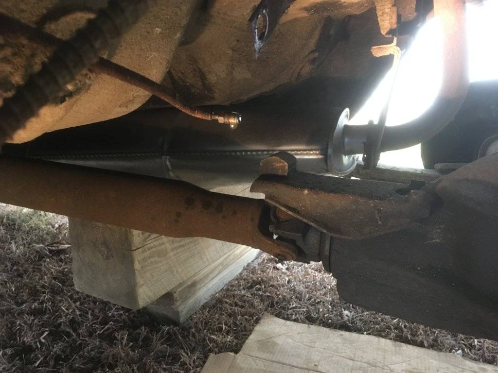

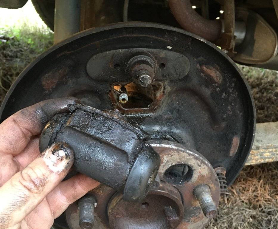

Seeing this car in person almost made me think I need one... almost... I have enough going on with what I've got already. No more parking left is really my saving grace though...View attachment 241911 Now that I have the 300 running good. I am working on the brakes. The pedal is very soft. I started gravity bleeding & that helped some. Experience told me to check rear shoes to see if they where bad. Shoes adjusted a little on the tight side & had a lot of lining left but brake cylinder was froze. The hard metal line is rusty so I twisted the cylinder out to save the line. I will check the other side too since I’m this far into it.

I think it’s both. I took some sand paper & cleaned up the line. Sprayed the nut with a rust dissolver. Still wanted to twist the line. Not ready to do a complete brake overhaul/restoration yet. Just want to get some brakes on it so I can drive it & see what all needs attention. I thought about some heat but I really think the line needs replacing.Bob is the nut rusted to the line or is the line so rusty you were afraid it would leak if it twisted a little bit? If it's just the nut stuck on the line some heat will loosen it, I deal with it all the time in the rust belt.
