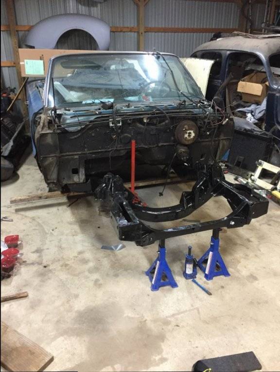

Hello,

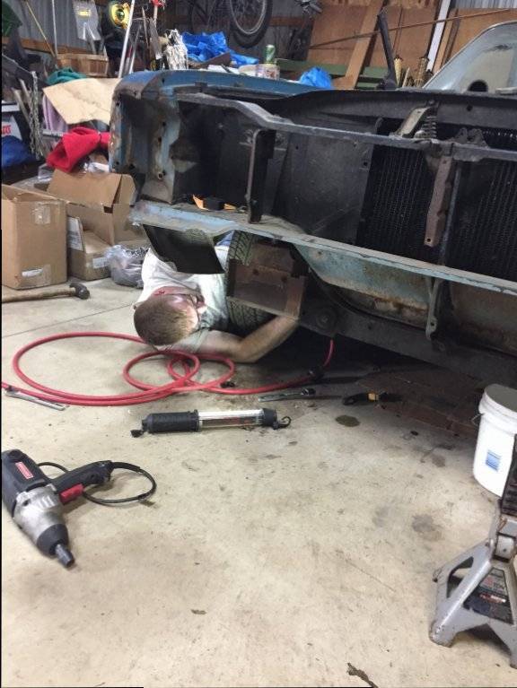

I got the old one out yesterday. It was pretty rough. Fell apart as it was coming away from the car. It looks like its not the original frame to the car, it was out before (had tape holding down the body shims) and there was remains of yellow writing on it(to me thats like a junk yard writing). I noticed a difference between the frame that I have and the one that will go in.
Where the torsion bars attach to the rear of the frame. The new one is solid. Like the ones in this link.
For Sale - 1965 Stub Frame
The old one had a torsion bar isolator that held the torsion bars and they just passed through the frame. I don't have any pictures of that. I can take one in the morning.
The torsion bars both measure at 47 inches.
Will this matter?
Also is there isolators that go inside of the rear transmission crossmember?
Thanks
Eric

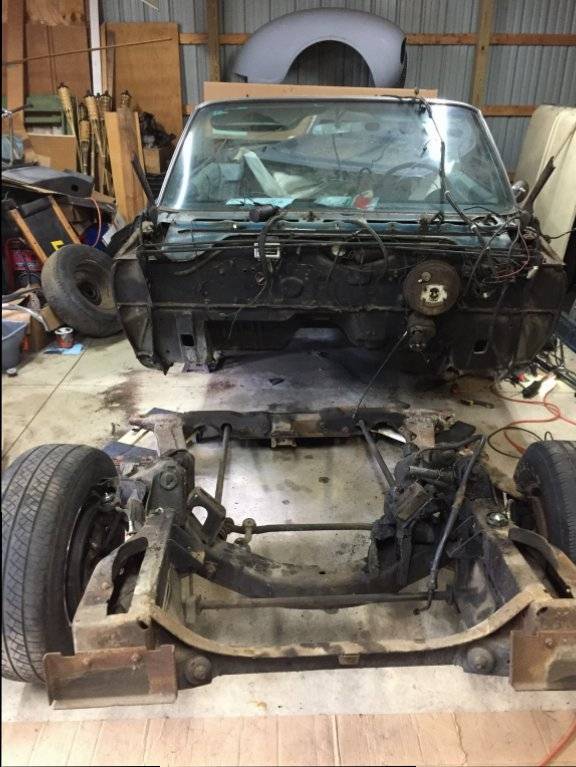

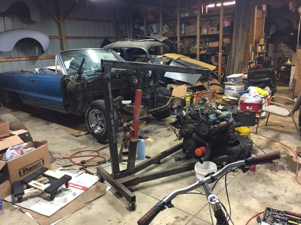

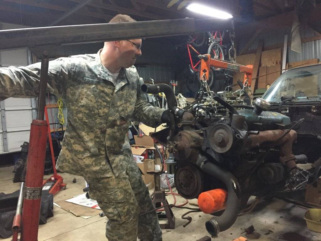

Well, My two weeks of working on my car has come and gone. It was a great learning experience and am glad that I did it. It took me 4 days to take apart the car down to the subframe and to remove it.

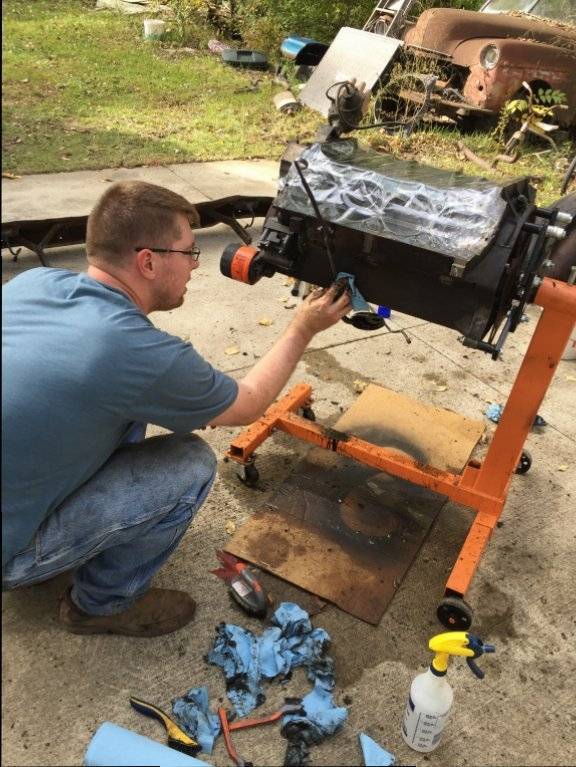

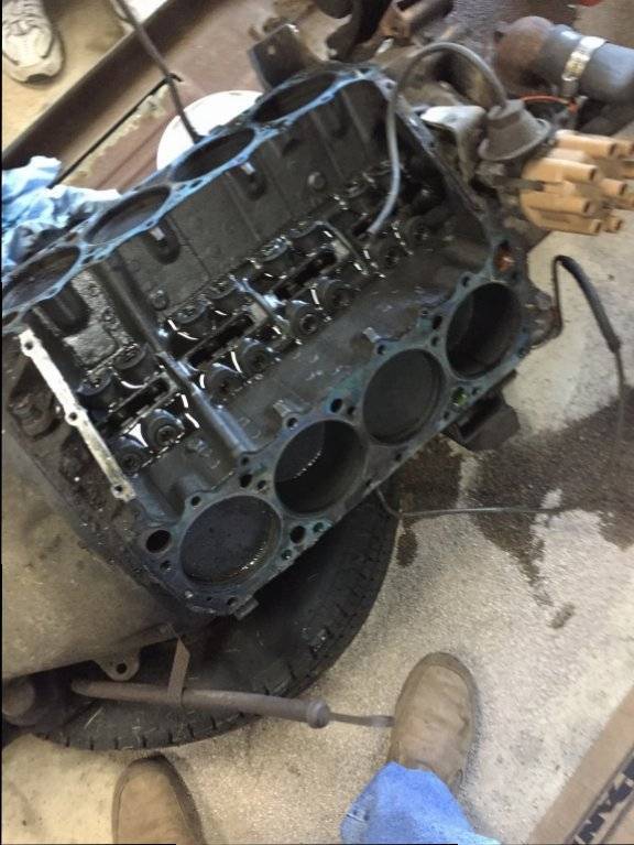

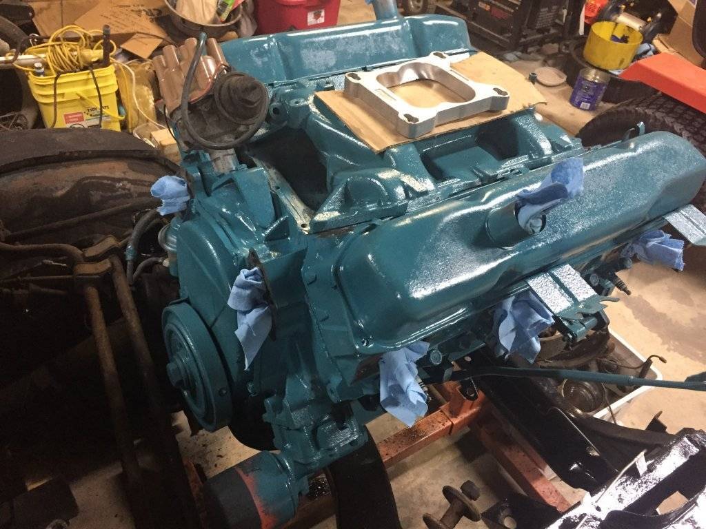

We pulled the engine and found out that most of the bolts holding everything together was just hand tight... valve covers and oil pan. Thus had a healthy coating of oil on it.
In the process of changing out the gaskets we found out there were several stuck valves and push rods. We too the Heads into the shop and had hardened seats put in while they were there.
While that was out and about I got the new stub in. It looks so much better. This is where we kinda stopped. I was working on the car Tuesday of the second week. And our usual body guy stopped by to talk to my dad about fixing some rust on his truck (above wheel wells). We got talking and I was telling him that I got a quote for 15000 dollars for complete paint job and body work. (I got the quote to see how much I need to save). He thought that was quite high. So he left and I continued on the car. The next day he came back and talked to me about doing all of the work on the body next spring ( as long as his health is good 73 year old gentleman). He came back with a price that I cannot refuse. He wants me to have the car blasted, recommended the dustless blasting. He says it will remove everything and he can fix everything a lot easier. So the car will be painted next summer so the subframe will need to come back out. We have a older trailer frame that we mount our bodies on to take cars over to his house (across the street from us).

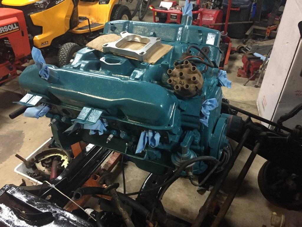

That being said, I didn't want to continue putting stuff back on the car just to have it come back off. It was Wednesday by this point. So I spend the last day and a half getting the motor back together. Didn't wan't to leave it all apart. Got it mostly together and painted. Then I spend the last day just organizing all of my parts. It turns out I have tons of extra parts that I didn't know about.
Well overall it was a good time. I'll be heading home often to be able to work on it. I'll attach a bunch of pictures. To show the progress.
