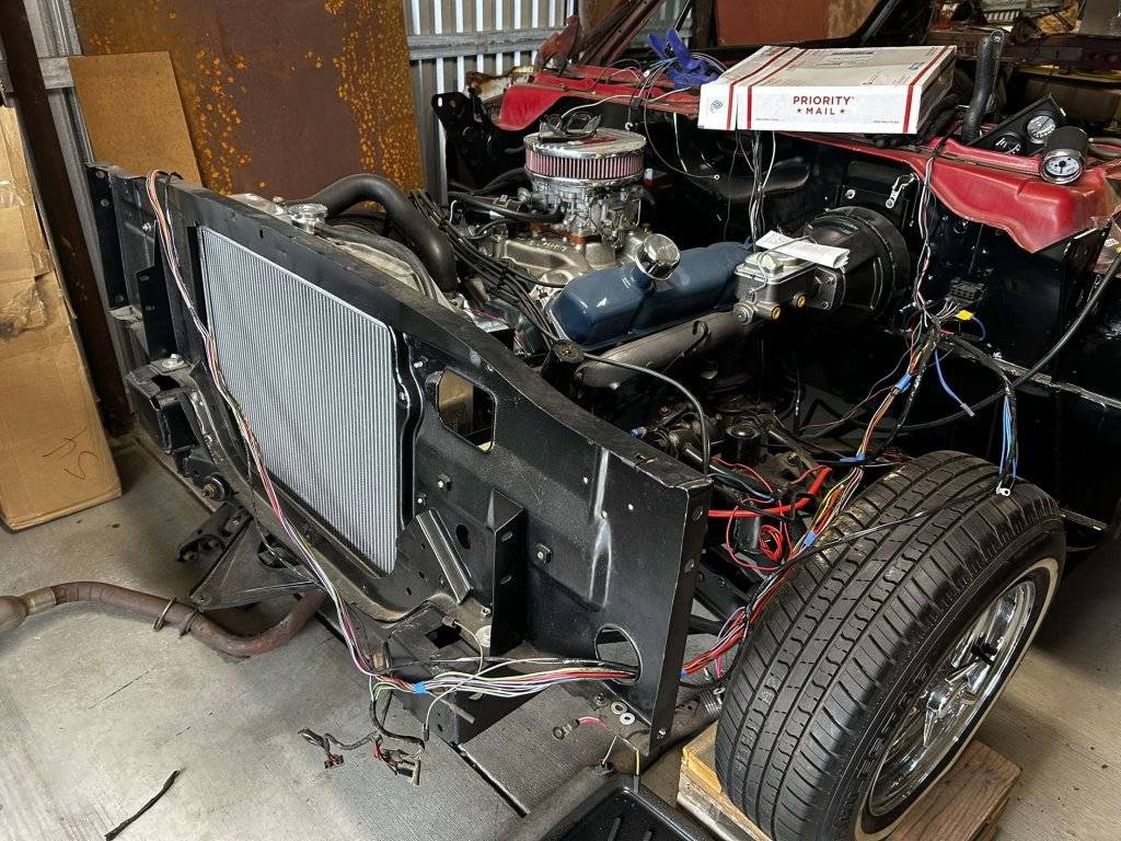

Although I slacked off basically all of 2023, I’m gonna hit it as hard as I can this year. I truly believe I will get to take this car on her maiden voyage this year. Biggest thing now is the wiring getting done by a pro and someone I trust.

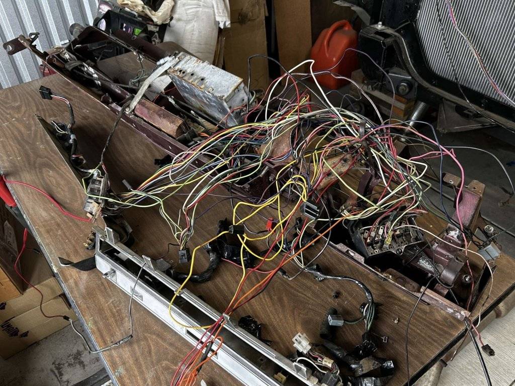

Wiring is surprisingly simple on these cars. Do you still have the original harnesses? Evans wiring can make you a new one if you can't find someone local. I'd stay away from a universal kit if I were tackling the wiring.
Yes, everything is in tact and in great shape. I’m not doing it myself or sending it off. A friend of mine is a wiring wizard and has done work on a lot of the lowriders cruising town. He’s real precise and likes to make everything look good as well as function well. Starting with the dash / bulkhead first.

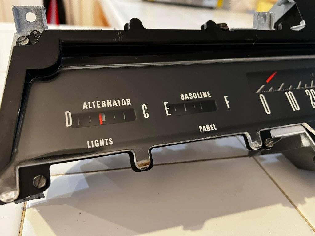

I’m actually stuck on how I should go about the ammeter bypass. I had my ammeter converted to a voltmeter.
I don’t think I’ll have to go the MAD route now?
Wire up the " new" voltmeter to a switched 12 volt source at fuse panel on positive side wire, and ground negative side.
Do the underhood ammeter bypass and connect the original ammeter wires together.
Make sure power is going in and out at ignition switch and blue wire at ballast wire.
