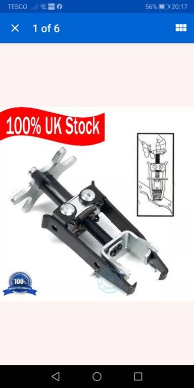

Well, I ordered a Air attachment from rockauto with a few parts I need and was thinking of this tool for the job?
