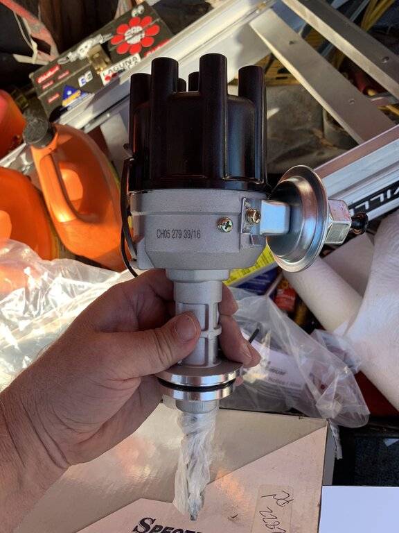

As long as the old distributor has tight bushings and the mechanical advance works, I would be inclined to use that one. Was the new distributor by any chance a Cardone rebuilt? A new coil, even if it is 50 years old does not age until it has power connected to it, so I would not worry about the condition of an older OEM coil.

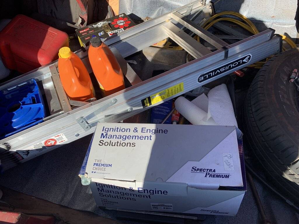

Good to know. I figured the coil juice might breakdown. No idea it was brand new from Checker and lasted 3 or 4 weeks. I put the old dist in and bought NOS points kit here on the site. But it’s run fine so I never messed with it. I keep a spare dist in the trunk set up because I feel it’s easier to replace the dist than mess with points on the side of the road. Yes I did put a good NOS tune up set in the crappy spare new dist. I bought 3 sets.

That is a new unit, made in China.

Check the box, some also were made in South Korea.
