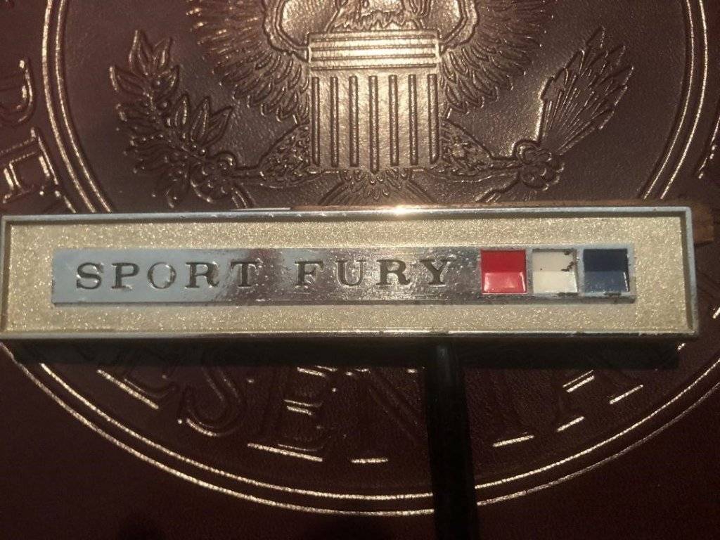

Argent Silver and Chrome are two different finishes! Argent is a metallic finish and Chrome, well, it is just chrome. I have used the attached extensively in my restoration project for Argent and looks fine, and matched a paint that I also purchased that actually was labeled Argent, and can be bought at your local hardware store. When I use on metal, I also bake it on at 200 degrees for 20-30 minutes - put in in the oven, turn up to 200 degrees and let the oven cool off with piece in!
