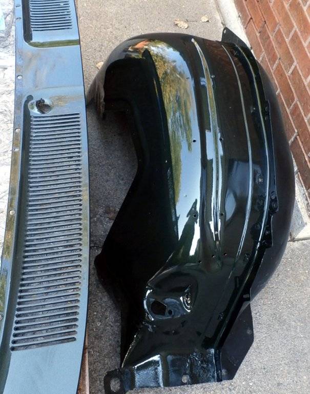

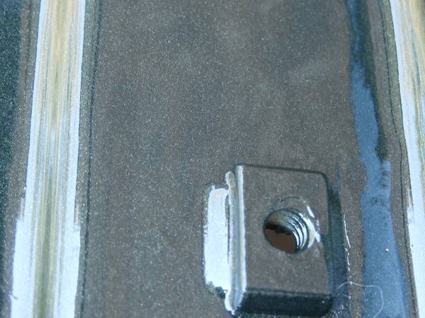

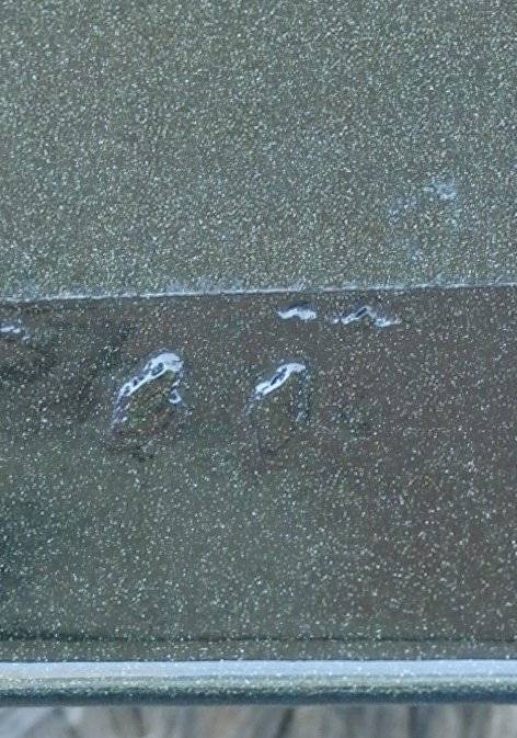

Here's my example of old paint vs new paint. The old paint isin't actually the original paint the car had. It was repainted in 1987, the instructions were to match it exactly. The example below shows an inner fender and the windshield or hood/vent trim piece (not sure what the correct name is, I'll just call it hood trim).
The hood trim is the 1987 paint, there's no wax on that. For the past 24 years that paint has had maybe a few hours worth of sun exposure. Note the left edge of the trim. This part is covered by the stainless steel windshield trim. I thought it could use more paint or better coverage, so that part got a shot of the new paint. Here's a close up:
Remember, the new paint has a clear-coat layer. Maybe too generous? It's hard to photograph glossy surfaces. Some of these photos make the difference between the old and new paint really stark.
When the paint guy made the first sample of the new paint, he put some on a stick and held it next to the hood trim (I brought the hood trim to the paint shop). While wet, on the stick, with the shop lighting, it looked like an exact match.
Here's a close-up of the new paint on the inner fender:
I think the gloss is amazing. No wax!

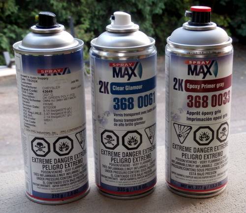

Here's the paint code info:
Here's what I got (base, clear, epoxy primer, each one in a rattle can):
Once the 2K cans are activated, you've got 2 to 4 days to spray it. I applied the clear maybe 1/2 to 1 hour after I shot the base. I like how it turned out, but to do a spot repair on an existing panel, I don't know, its a lot of work.

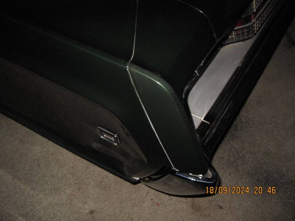

I did a test paint on the left quarter extension but only on the outer vertical surface. It is not perfect but not bad either imo.
It is too light. I think if I would paint a quarter and have the door unpainted it might be painful for the eye.
