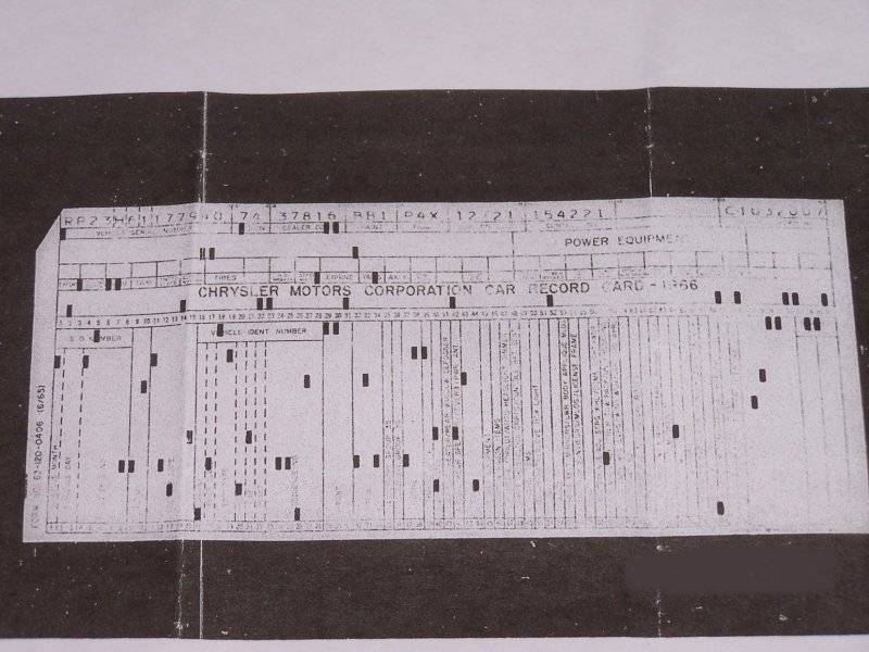

I believe they have records for '69 and earlier. This is what I got:

What you get is a microfiche copy of the original IBM card produced for your car. (A copy of a copy) All other documents for the car were generated from this card. The tell you things that are and are not on a broadcast sheet (i.e. dealer code, shipping date. there are details on a BS that are not on an IBM card.) It's considered one of the definitive documents for your car. Yes, it is worth the price IF they have yours on file.
Some caveats:
The have cards for most 67 and earlier cars.
Some of the copies are very hard to read but there are people that can help.
I have seen mistakes in their decodes. Just like a fender tag, there are nuances to interpreting the IBM cards. Trust but verify ;)
