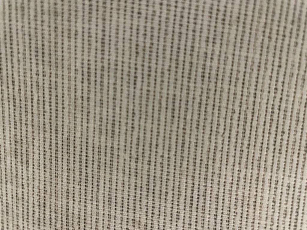

On tux the white head liner is looking dirty, I was starting gently, but the tiny threads are the weak link. I stopped before creating a bigger problem.

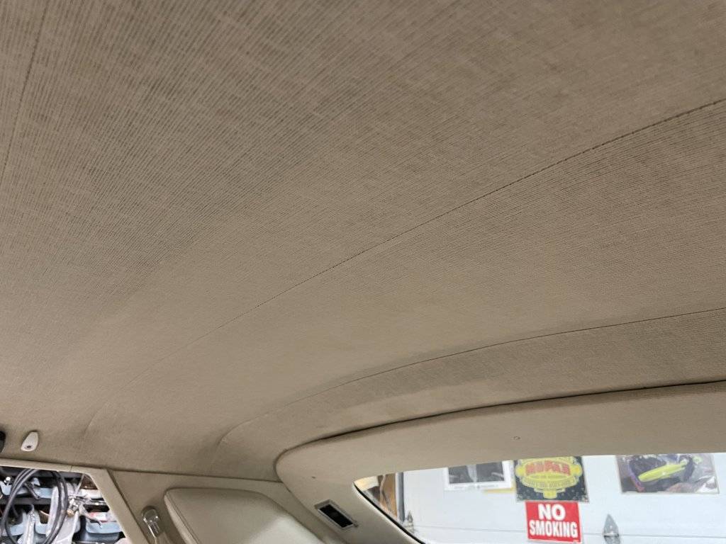

What it looks like on my top is that some areas do not have the insulation behind giving a darker appearance. One option I have thought of is remove side trim completely mask off interior and spray with SEM Super white.
I will be looking into a good cleaning process more this winter. Or live with it.
In the picture you can see the darker and lighter, at first I thought it was dirt, but the lighter areas have insulation padding behind the material. Maybe it was never installed or it has turned to dust, I would like to add insulation as the roof radiates so much heat into cabin.
