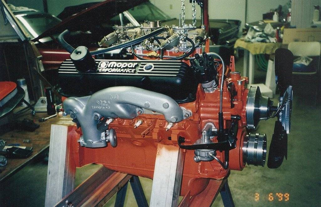

Unlike former times when we could still get OEM quality Dana/Spicer/Perfect Circle fan clutches that LOOKED like they were OEM production items (even with ink stamps), the ONLY real option is now the Hayden fan clutches. They are in "std" or "HD" flavors, which depends upon how much they lock-up when at max cooling settings.
Fun Fact -- Many Chrysler-spec fan clutches also fit Chevrolet small block V-8s! Same shaft length and center hole registers, which means they bolt right on to the water pump. Not sure about the bolt pattern for the fan, but it looks like that will work, too.
Which FIN COUNT does the radiator have? That makes the difference between a normal and High-Efficiency aluminum radiator. The width of the core's tubes also matters! A core with wide 2-rows can cool better than a core with thin 3-row tubes.
Unless the front fan runs faster than the rear fan, it could be blocking/restricting total airflow!
NOW . . . if you want a high-efficiency OEM-spec radiator, order a new composite radiator for a '77 Camaro w/fact a/c (this radiator is the same number as fits '87 ElCaminos and 1/2 ton pickup truck V-8s) AND is the same basic core size as a Chrysler 26" radiator. Only thing is that it will need to be installed in the cross-flow OEM orientation. Which means a some re-routing of the atf cooler lines, AND appropriate brackets to mount it to the Chrysler core support. Less expensive than the "332" Chrysler 26" radiators and should work better, even with normal fan clutches.
Just some thoughts,

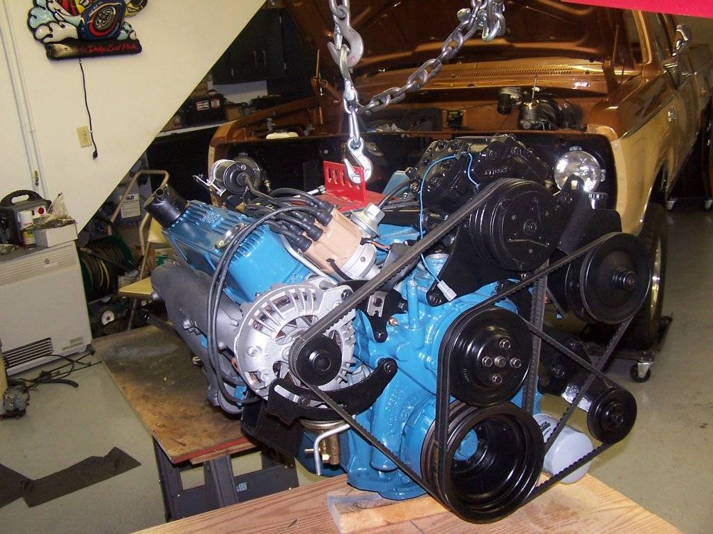

Yes I am running a serpentine which came as a unit with a/c pump, power steering pump and alternator. The serpentine was the result of installing a/c with factory dash with a/c I got out of Dallas. As part of the restoration, I was attempting to “fix” a problem of overheating here in Phoenix but I had the same problem, to a lesser extent, before I moved from Omaha. Seems a lot of the Mopar folk here in Phoenix fight the same issue with different options and results with no real pattern. After much discussion including spacing issues, this seems to be my best option! A friend here in Phx. Has a 65 SF but running a 440 m and has the setup I am after and has had good success by going to a 26” radiator with this fan setup and runs 180-190 on a hot day. My thought is that if it works for a 440, it should handle my little 383. Ron Davis has been very helpful on my new mission.

I think your overheating issue at idle is due to your serpentine pulleys. Most of them are "under drive." Meaning they under drive the pulleys to increase horsepower. Trouble is, the crank pulley is an inch or two smaller than the factory one. What happens then is the water pump does not move enough coolant and it stays in the engine too long. The alternator and power steering can survive the slower rpm but do suffer some as well. I remember on my Challenger it would over heat at idle and my amp gauge would show a slight discharge at idle. Once I ditched the under drive BS, I had no more heating problems and also noticed my amp gauge stayed at zero at idle also. I know you don't want to hear that cuz those pulleys are sooooo nice and quiet. Maybe they make a larger crank pulley that will solve your problem. Turns out those Mopar designers were smarter than we thought they were. Here are a couple pics. My Challenger Six Pac with the serpentine and my 440 powered truck. Check out the difference in crank pulleys. My Truck could idle with the AC on and never overheat.
