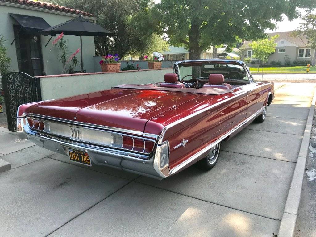

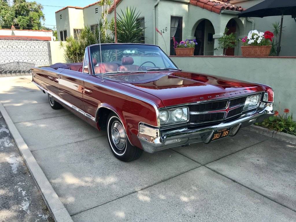

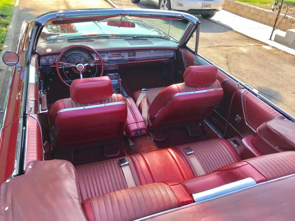

Nor am I. The wife and I went to grab a cheeseburger and catch up with some friends we haven't seen in a while. I hadn't been to that cruise in years and didn't even know they gave out awards. Pics from this evening before we left:
