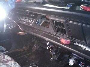

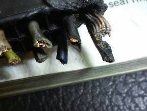

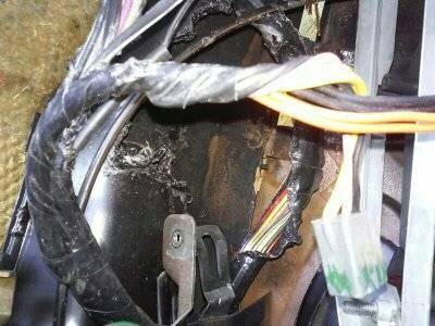

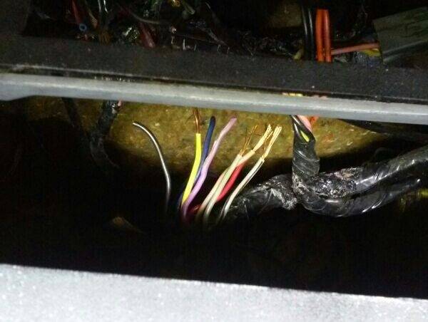

Oh, mine was my own fault, at the time, i didnt know that all the current goes through the ammeter and the studs were THAT exposed. I pulled it forward to reach behind the dash for something and grounded it. Was completely cluless about what happened until the starter started spinning. Im specialist in battery disconnecting in 3 seconds now lol.

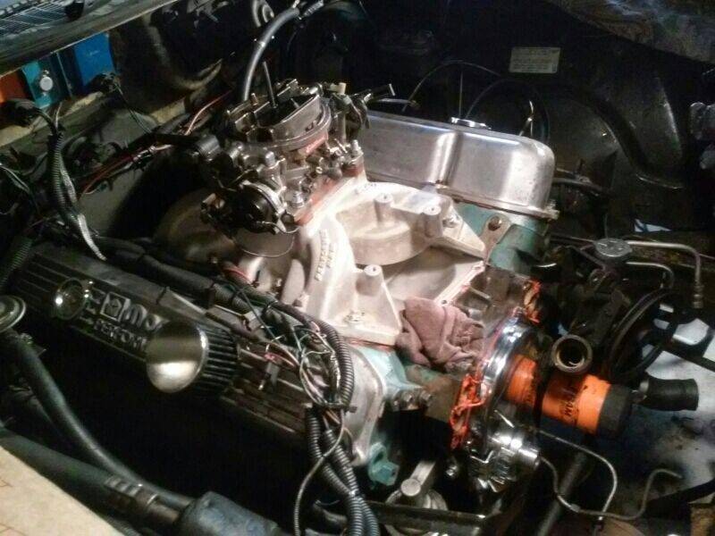

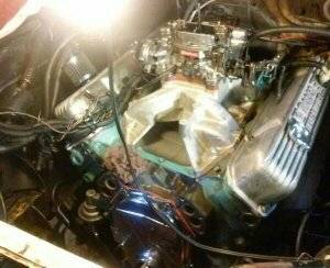

Some more of the nastiness....It was really tough trying to work in the very limited space that was in there.

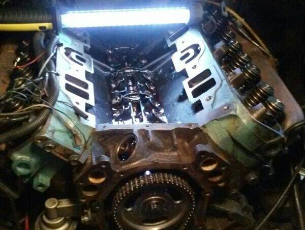

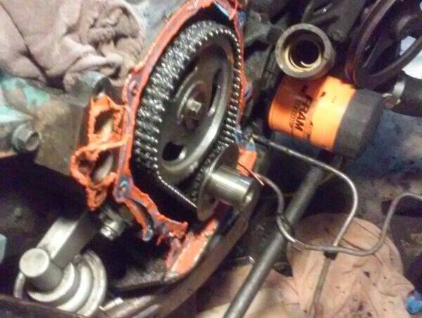

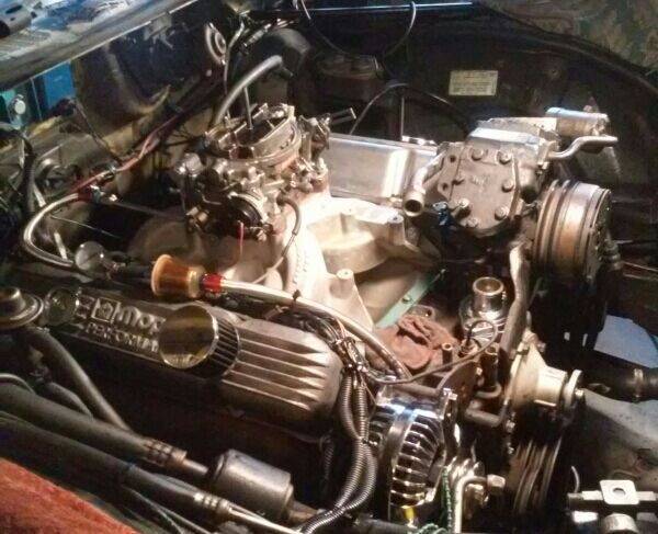

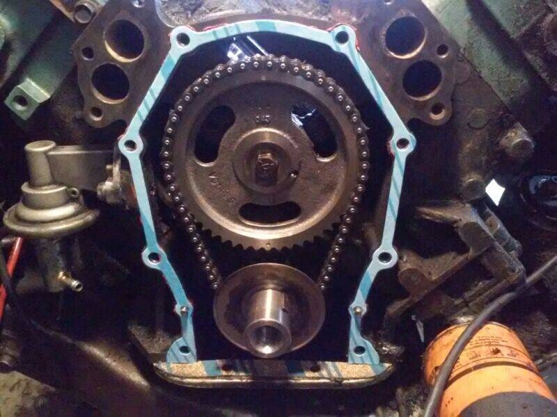

And of course THAT had to happen almost directly after I did a cam/lifters/timing belt/gears, water pump....blah blah blah swap. Oh and I had to buy one of those bendable stick tools with a magnetic tip and light at the end of it; I dropped a damn bolt right down the distributor hole. Dropped right into the oil pan. My wife suggested I try getting it out with that. It worked. Bless her.
I am sorry to hear of your experiences... I had an ammeter wire ground out on a 73 Charger I had when I was 18... burnt up several connectors. It was the start of my electrical diagnostic skills, which was a big part of my career... oddly, I look back on it fondly. I know I was miserable at the time.
Thank u cantflip. I hope I can look back at this fondly some day too. I don't ever want to see flames again though, lol.

BTW glad you took the pics after the fire...

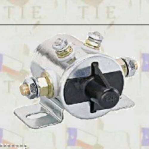

Yikes. The look on my face as I saw those flames coming out of the vent must have been classic. Thought I was seeing a mirage, a bad one, lol. BTW - opinions...where would be the best place to put a disco switch? Its only way now that I can rest easy 100%. I disconnect the batt when the car is in the garage; but I'm thinking I'd like to do that while away, without having to pop the hood, if its possible.
My first thought was wheel well, but it could get bumped off on you there... look around under the car for someplace you could put it safely and still get to it easily... try one of these ones so you dont have a key to loose. If it were me, I would do the ground side of the battery and would use 2 parallel switches to assure a good ground, but I'm overkill that way. Ground side assures you wont have any problems if a wire rubs insulation off somewhere.
Thx cantflip. That's a thought. Finding a convenient but sound spot where I don't have to open the hood all the time is going to be a trick.
This is the slick way to do it. A 12v (N.O.) relay activated by a fob that you carry that activates a Heavy Duty mechanical relay installed between the battery post and your cable. All tucked neatly away under the hood.
