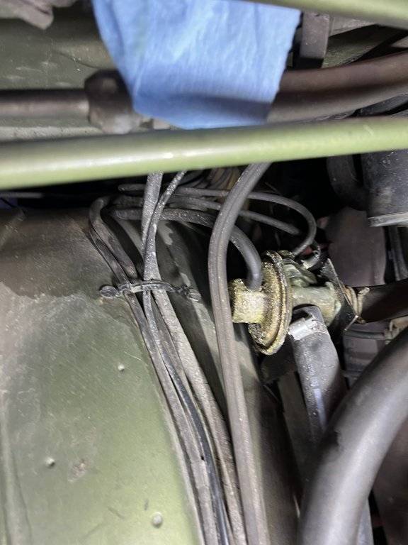

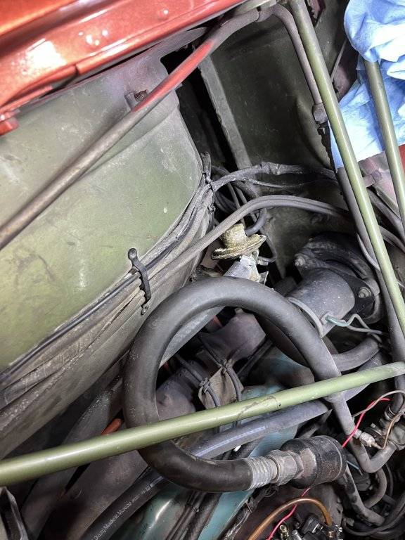

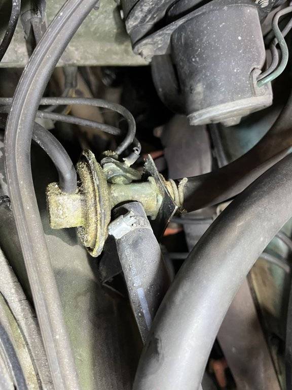

This metal part is leaking coolant in my 68 Imperial Crown Coupe. Does anyone know the name of the part and hopefully where I can purchase one ? Thank you in advance for sharing your knowledge. Best Regards, Andy

It's a heater control valve or if you look in the Mopar parts book, it's called a water valve.
This one might be a little tough to find as it looks like you have the Auto Temp Control, called ATC.

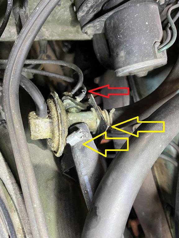

Before you go crazy looking for a new one, make sure that the valve is leaking. I see some hoses in bad shape, one with a factory type spring clamp. (yellow arrows) I wouldn't be surprised if that's your leak. Also, it looks like a vacuum hose that's broken. (red arrow)

If your valve is indeed leaking (I agree with checking hoses and clamps first), you can see if this guy can rebuild it. I have had a couple standard ones done by him and the work quality is good, it's quick, and the cost is very reasonable compared to replacement options. heatervalves.net - Home
