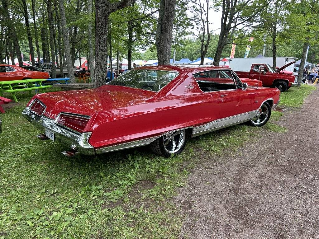

I have a 67 Monaco with a 22” factory rad. Has anyone ever switched the rad support to the 26” version? I have a built 383 in it and cooling can be an issue sometimes.
I have a line on one out of a 66 Chrysler 300 but am not sure of the fitment. Want to ensure it’s exact as there is shipping involved.
Any input is appreciated!
IIRC you may have to stick with '67-'68 Polara or Monaco 26" rad support. Not sure if '67-'68 Fury or Chrysler would work. Others here may have a more definitive answer for you. Good luck and that is a beautiful Monaco you have there.
I would be shocked if a Chrysler rad support wound't fit in a Monaco. But then again I'm shocked that your car overheats in Nova Scotia.:rolleyes:
Hey - did the car originally have a 383? If so why didn't it come with a 26" rad?
(can you post the fender tag? Nice car.)
I concur, neat looking car. In one of the "right" colors, too.
