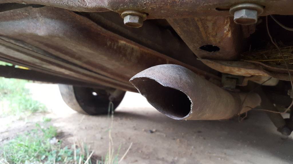

My 73 fury u code has these tail pipes on it. They are 2.5 inlet and 2.25 outlet I believe.
