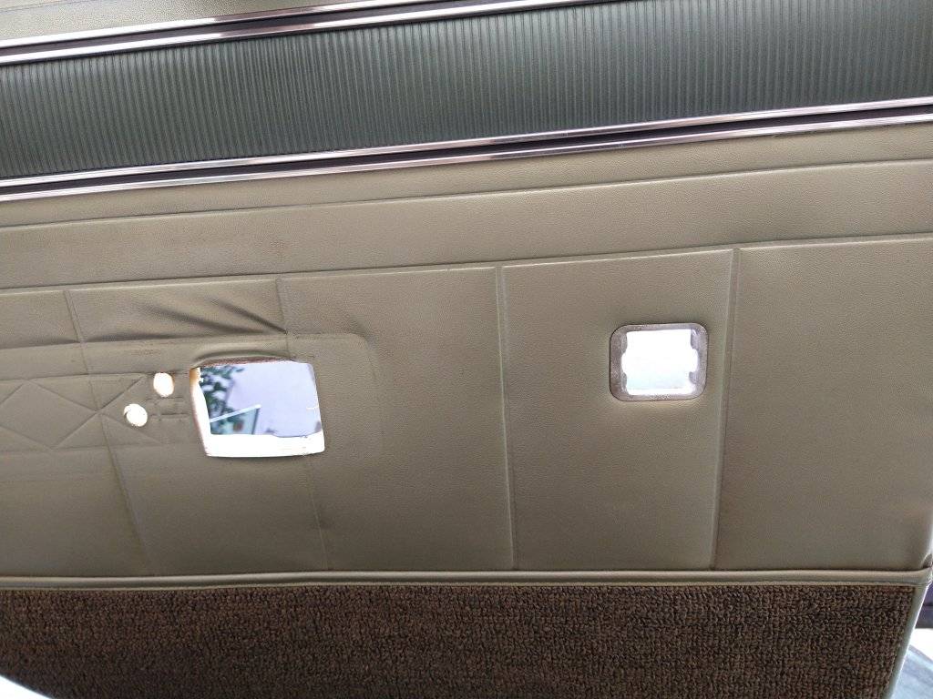

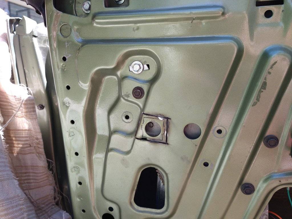

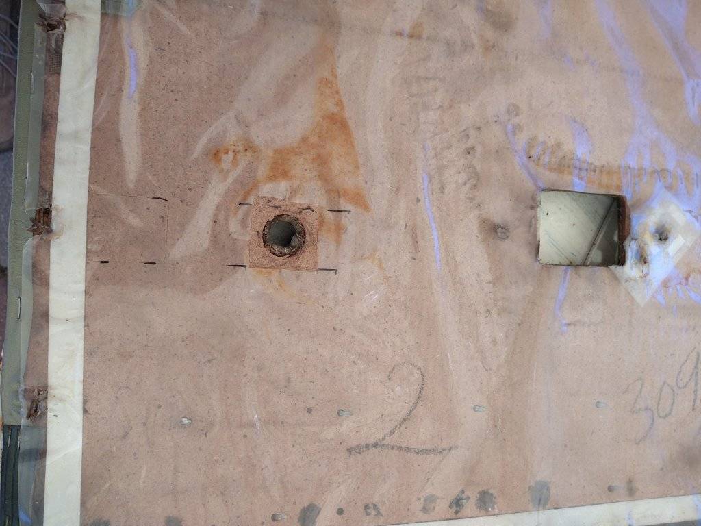

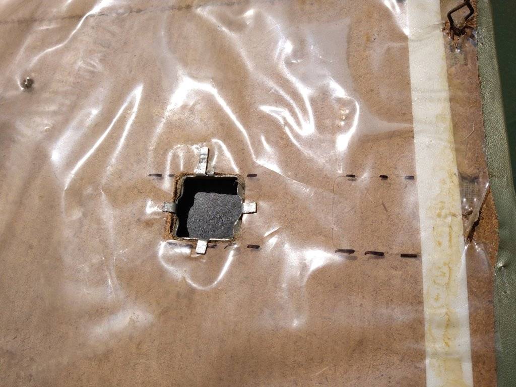

I did my '68 Monaco 4dr , purchased all four regulators and wiring harness/switches. I got my idea when i looked back of the front door panel there is a perforation for switch same place where the crank handle so i tought easy-peasy. Later realized the rear ones are couple inches forward,so started pulling my hair what to do now. Decided to use same crank hole for the switch but had to cut out a bit from door frame because the switch need more space. And use less space as possible i made my own terminal connectors of general bullet connectors. Not the best probably but so far so good.
