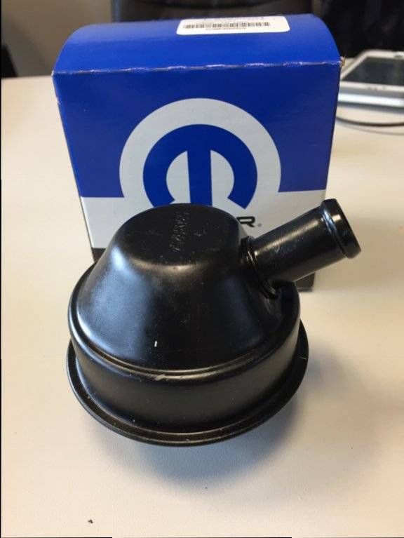

looking at the 70/71 parts book
3462094 w/o ECS (1 tube)
3462095 w/ECS - 6cyl (2 tubes)
3462096 w/ECS - 8cyl (3 tubes)
ECS-Evaporation Control Systems
3462094 w/ECS - 8cyl (3 tubes)

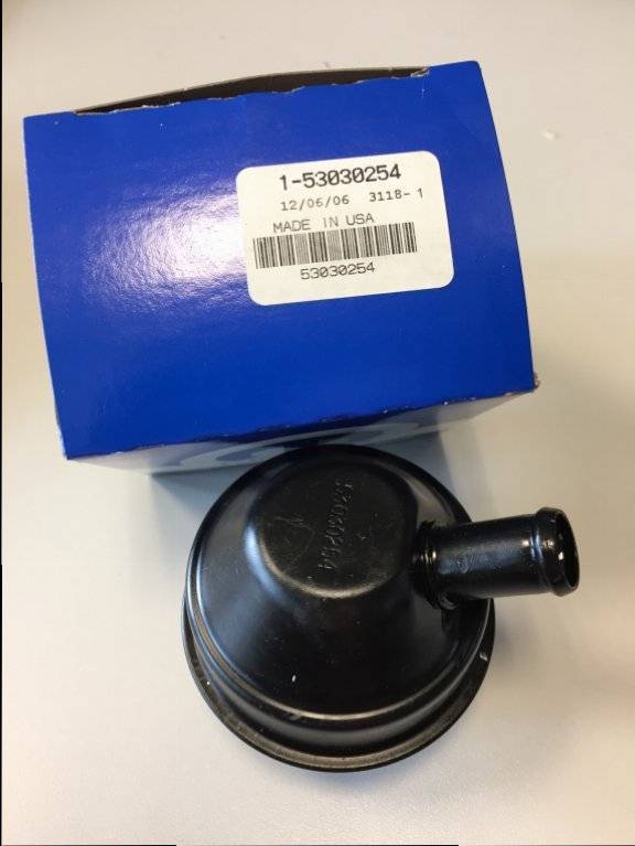

3462094 changes up to 53030254 there is some still on shelves but you repeated the part number for the 3 tube so which is which?
oops, cut-n-paste

Ok that makes sense. The 3 tube is out of stock but there is one dealer showing "1" of them in the USA. I can provide the info so if someone wants it PM me

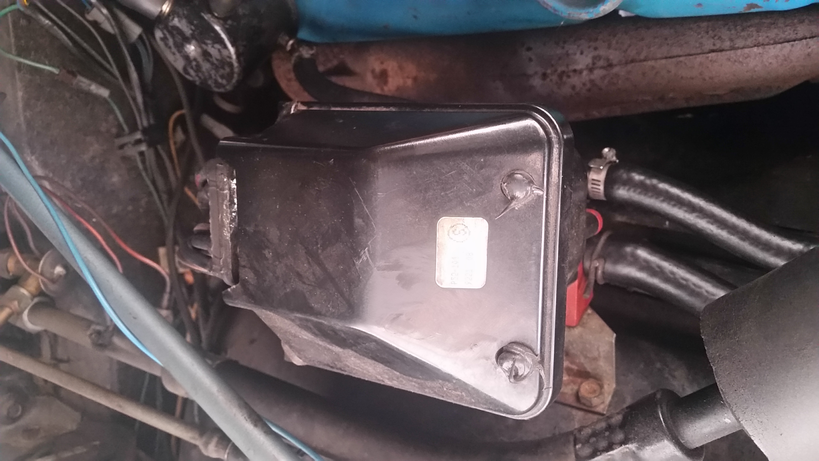

I had the same issue removing my breather. It spun but wouldn't easily pull out. Some silicone spray and steady pulling pressure while rotating it got it out. No prying. Surprisingly, the rubber grommet was ok - not too hard. I was even able to remove and reinstall it with no issues, so I could paint the covers. Heating it up helped greatly.

This is what Mopar has for this application....PM me for info

Even if you do use the ECS breather required to meet the California regulations back in the day, I still would not use the third nipple for its intended use on our old cars. It was there to take any evaporative fuel vapors escaping from the fuel tank and send them ultimately to the crankcase, thereby diluting the oil and in some rare cases also causing the oil pan to blow off during startups. A cheap, dumb idea by Chrysler to avoid the expense of using a charcoal vapor cannister. I will probably leave the 3rd nipple looking like it is hooked up just because I tend to be a purist, but it would not be functional, having accomplished that where you can't tell when looking under the hood.
