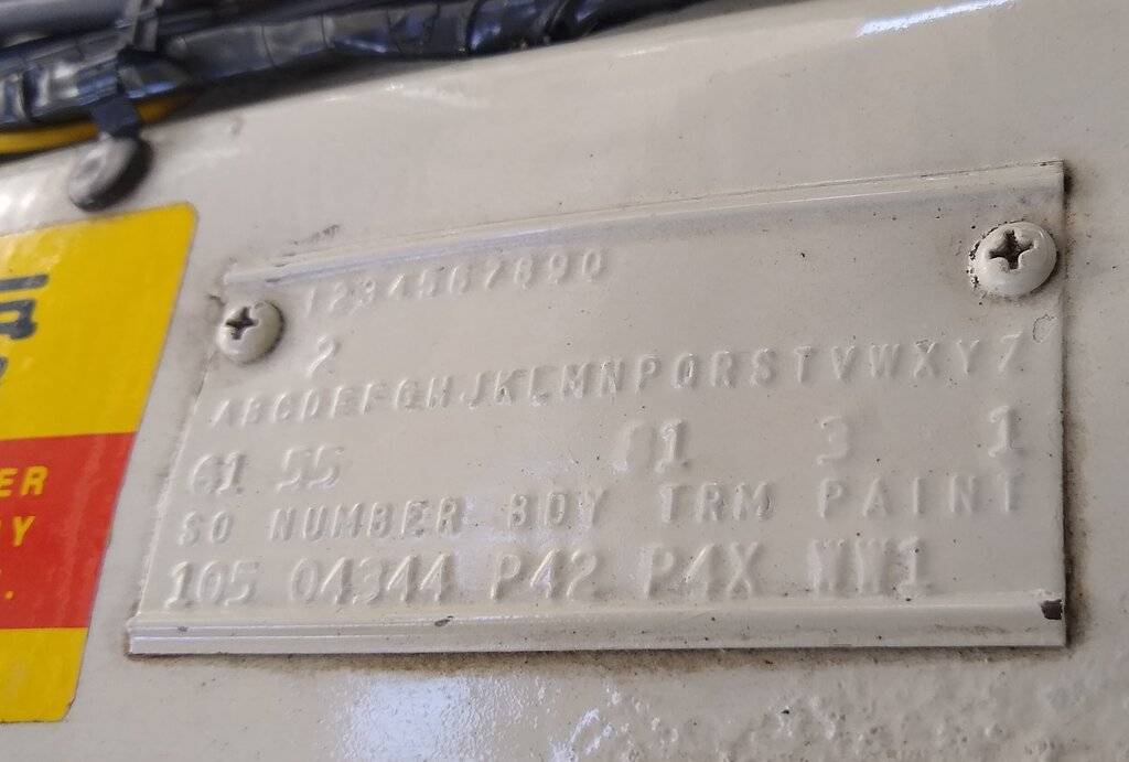

Fender tag as well...

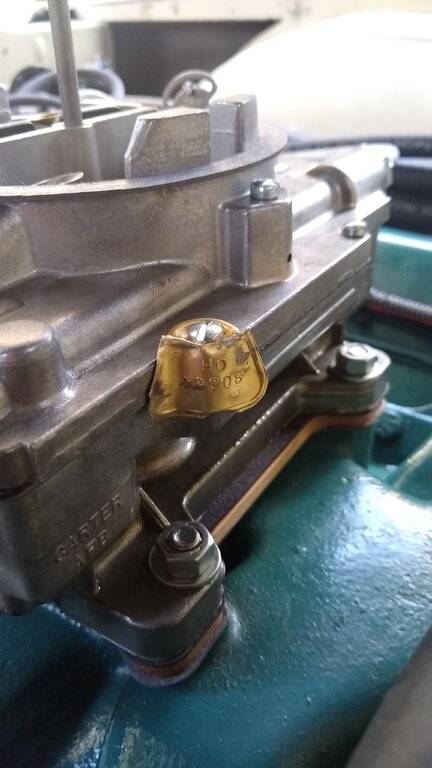

A couple of sources show this is a Chrysler, not Plymouth, application. Compare the date code on the base of the carb to your engine assembly date. The carb date should be ~1-3 months ahead of the assembly.

From the day I started looking closer at my motor, I felt I had a Chrysler block. I don't know why I would have one in there, but odd things like the oil cap and PCV were blue, when I repainted them black, I sanded them down...and it was blue to the metal, so it's not like someone painted them wrong. My oil dipstick shoots straight out like a Chrysler block. I have a Chrysler carb, as well as I have a small unsilenced air cleaner like a Chrysler would have. The carb spring bracket looked like one from a Chrysler, and the battery negative was bolted as a Chrysler would be.
So these small oddities lend me to think that the motor was either replaces at some point with a year correct block from a Chrysler, or somehow this block was left over from 1964 and got put in the car.
Either way, it's now looking like a Plymouth block should and no one would know the difference anyway. Whomever put the motor in took the time and care to make sure it wasn't just done haphazardly.
