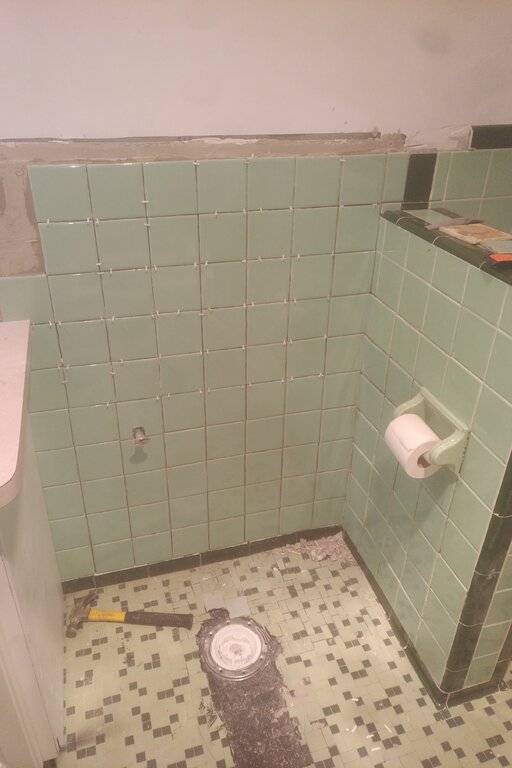

I'm reconfiguring a vintage bathroom. (No desire to rip it all out and start from scratch.) I was able to find matching wall tile. But the dark green "mud caps" are proving hard to find. Generic white are literally pennies each and available. (The pink countertop is for mock-up of plumbing)

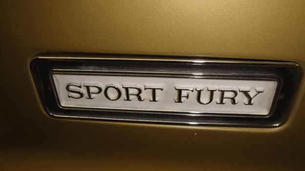

Sport Fury front fender call outs, White background, Black border.

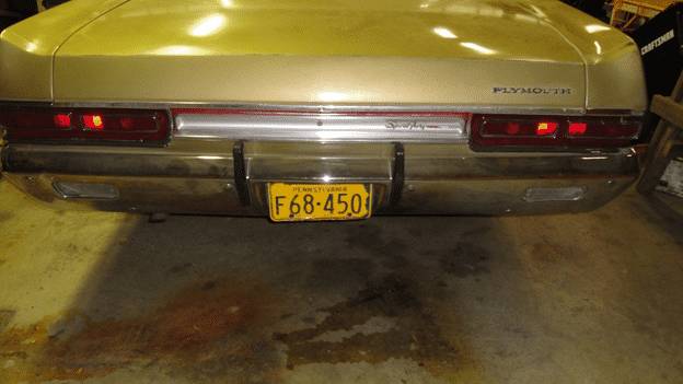

Rear trim panel, Red, White and Blue Chevron’s, Red “to match taillights” around outside.

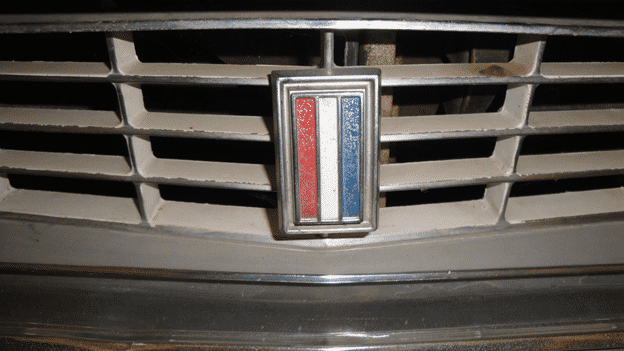

Grill Emblem – Red, White and Blue

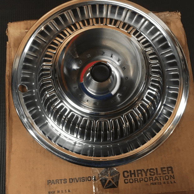

Wheel covers – Red, White and Blue center, Black inserts outside. NOS example
