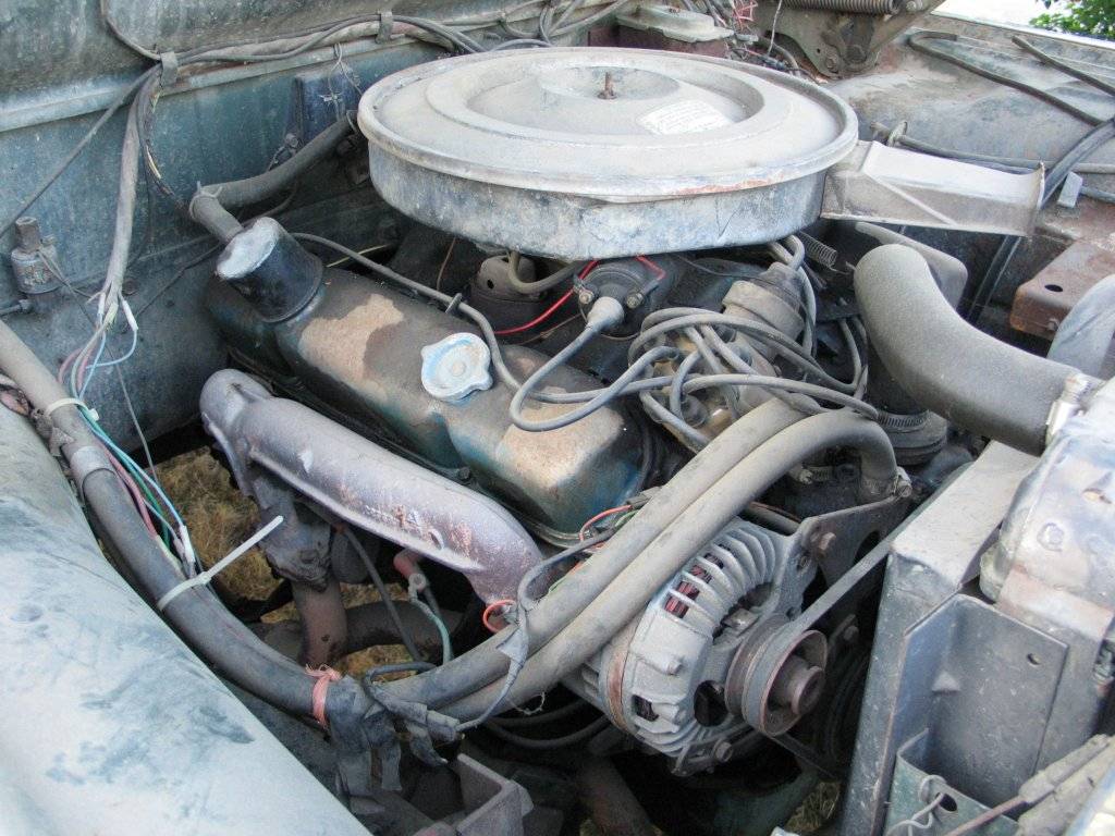

I was resurrecting a 1970 383 that hadn't run in ages, it started but then all the sudden started running really rough and lost all oil pressure at the same time.
I was mortified, original motor, 58,000 miles on it, when to me 100,000 is just broken in for a 383.
Pulled the valve covers on a hunch, bent pushrod laying to the side and lifter spit out of its bore, hence the massive oil pressure leak.
Scored a set of pushrods on eBay, still have the other 15 just in case.
Turns out the valve covers were condensating in certain spots, rockers and valves rusting here and there because of it.
I cleaned it up and all good, still a turnkey engine to this day.
