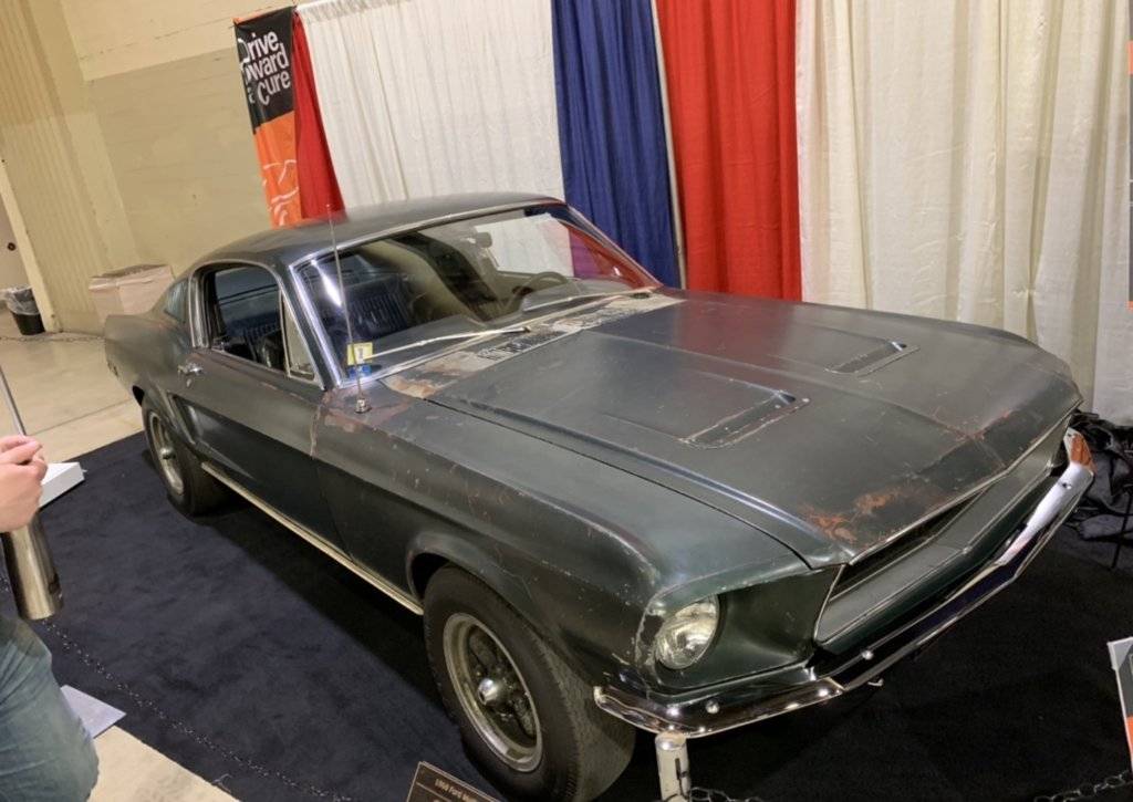

3.5 million bucks ?!? That’s crazy. Me & my buddy’s dad sat in it at the GNRS last year or two years ago. Now I have great respect for other people’s stuff but once it’s up for sale or auction I’ll just maybe feel free to sit in it. Yes I’ve sold cars at auction and people have stolen parts and killed my battery on the for sale field. The only real auction rule is DON’T door ding the freakin cars. Those little clock/ odo reset knobs go missing like a mad man... I do let people sit in my cars at cars shows. They’re only cars... anyways it was pushed in a corner by where the pinstripers were and nobody could give a $&#% about it. We asked a kid in charge if we could check it out cause it’s for sale and he said yes. We both sat in it and the kid didn’t know who was selling it so we left. I figure I did about 2 or 3 hundred grand worth of time behind the wheel. Gotta love minimum wage watchdogs.

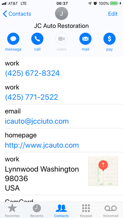

I used (JC Restoration) our if Washington State, Seattle area I think. Used them for my Window Switches and Power Antenna as well.. owners name is Jeff. Very nice man to deal with.
