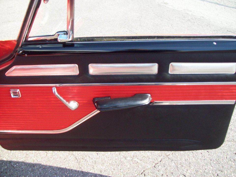

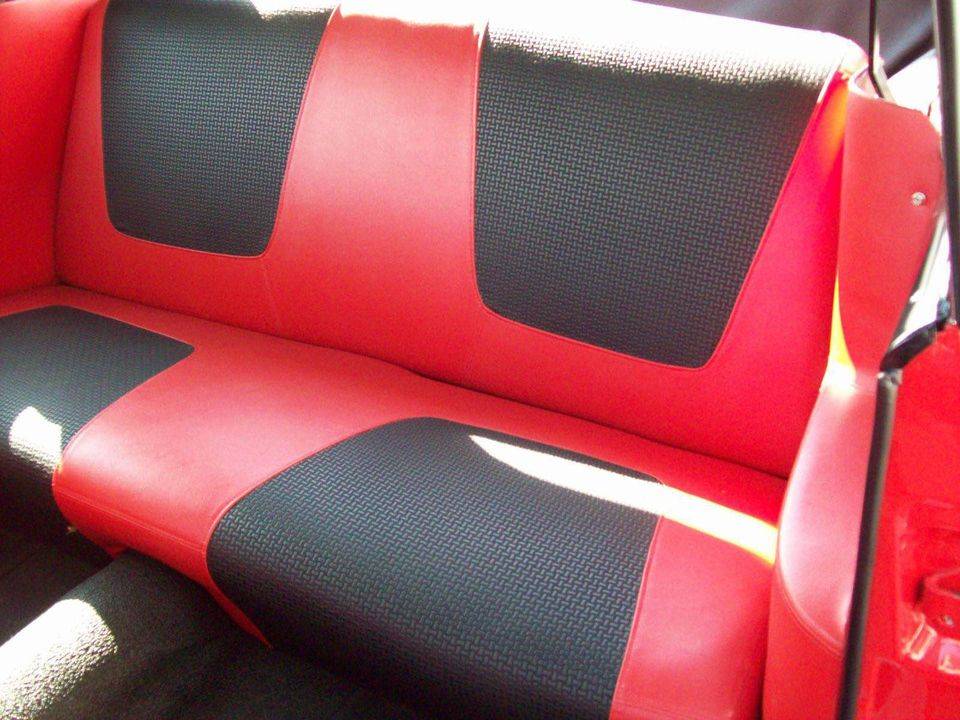

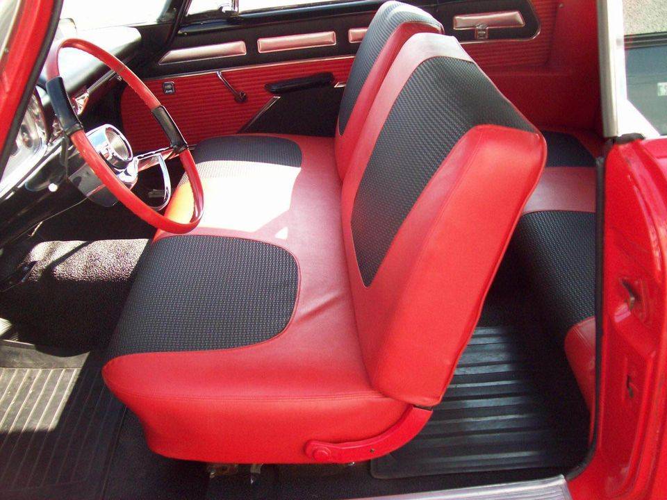

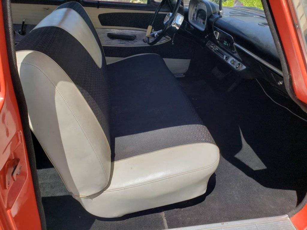

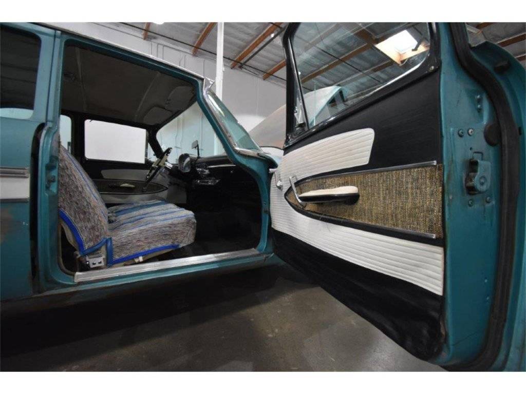

I have a few 'Belvedere' interior pics for you: Yours was probably black and white except if the steering wheel was green/blue then probably a green/white interior.
The hardtop/convertible vs. sedan/wagon door panels were different, on some wagons there were hardtop seat design overlap but not door panels.

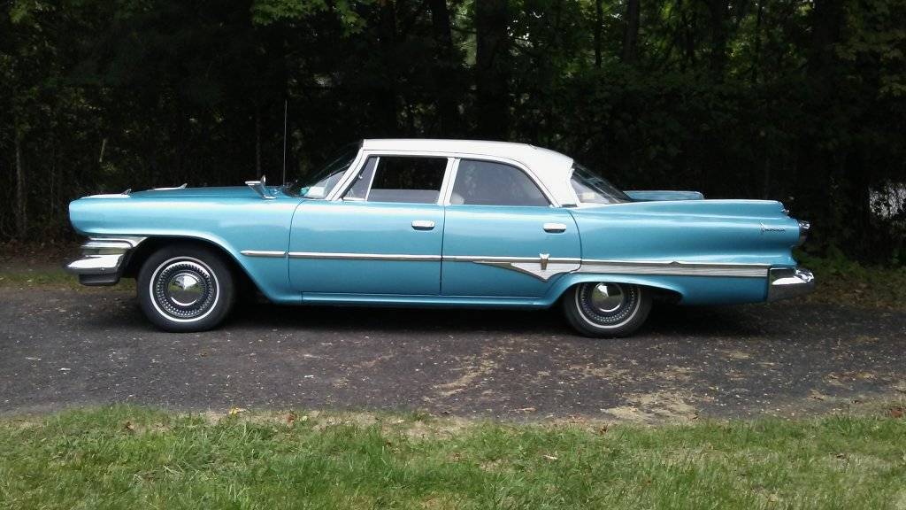

I second what W. Weiland said. The pale sky blue with white is really nice and we don't need any more Christines (as cool as Christine is).

The photo is of my '60 Dart which is a somewhat darker blue with white top. I picked these colors. The car was dull gray when I bought it in 2021.
