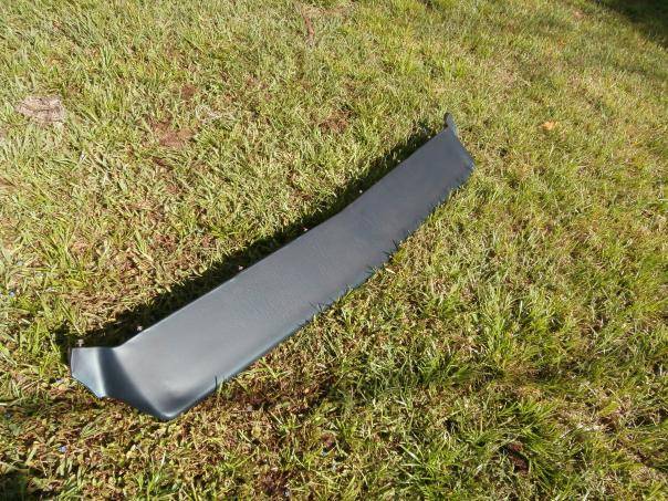

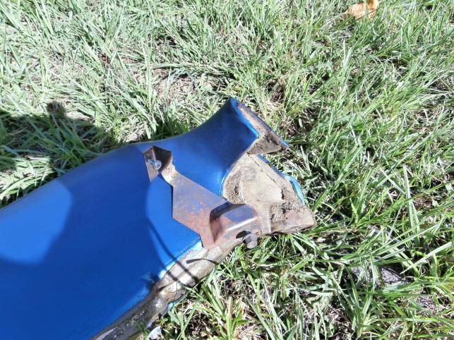

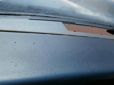

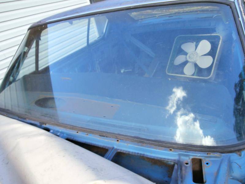

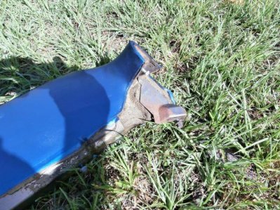

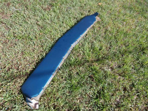

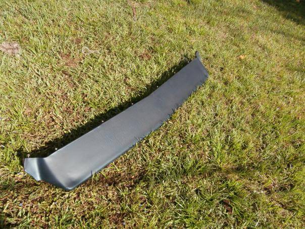

Winner, Winner, chicken dinner. I got the sucker out thanks to our knowledgeable group. Looks good to me. Some little cracking. The metal piece on the right came unglued from the pad.68 dash pad 001.jpg68 dash pad 002.jpg68 dash pad 003.jpg68 dash pad 004.jpg68 dash pad 005.jpg
