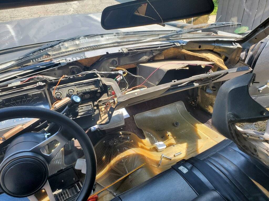

Some General Directions
1970 Fury AC Dash Removal
· DO NOT HAVE TO REMOVE WINDSHIELD or A-PILLARS
· Remove the plastic cover from under the steering column.
· Remove the two bolts holding the steering column to the dash lower edge and let the column rest on the driver's seat. I had already removed the steering column and seat. If your car is like mine, you have two studs and two nuts (instead of 2 bolts). The studs should be removed as well as the nuts, especially if you are going to leave the steering column on the seat. You may be able to remove the studs with double nutting. Otherwise, remove with a vise-grip and replace.
· Remove the four screws in the windshield defroster vents, two vents each with a screw on each end. 5/16 short socket, swivel, 6 ext, 3 ext, ¼ ratchet. These screws do not attach the defroster vents. They attach the front of the dash pad to the top of the firewall. 4 separate screws attach the defroster vents to the firewall. Do not attempt to remove these.
· Remove the door sill plates and side kick panels.
· On the engine side of firewall, unplug all the cables from the bulkhead connector. On the passenger side of firewall, remove 2 screws holding the bulkhead connector and fuse panel to the firewall.
· Disconnect the speedometer cable by pushing the clips together and pulling out of the back of the speedometer.
· Unplug wiring harness connectors at the sides under where the kick panels were. These are rear body harness, power seat, power windows, rear speakers, convertible top lift motor, etc. There are a bunch, but each has a different shaped connector so reassembly is easy.
· Next, disconnect any control cables/vacuum hoses running between the heater box and the dash heater control. Heater box stay in the car or is removed separately.
· For AC cars, at passenger side of dash panel under glove, remove 3 PH screws holding AC duct to bottom of dash panel.
· Unplug the radio antenna.
· Under the dash at each end you will find a bolt holding up each end of the dash assembly at the top of where the kick panels were. Loosen these bolts, but do not remove them. The bottom of the dash frame is slotted allowing you to lift it up and out.
· At this point roll the dash towards the seat and lift. Move it out about 5 or 6 inches and check to see if anything is left connecting it to the car. When clear, lift it out.
· If the instrument cluster is still in the dash, it has to be removed before you can detach dash pad from dash panel.
· To detach the dash from the dash pad: there are 7 nuts that mount on studs from the bottom of the dash pad through holes at the top of the dash shell; 3/8 ss, swivel, 6 ext, 3 ext, ¼ R. Six of these nuts are on the right side and one is in a corner on the left side. Remove 5 PH screws, one at each end of the pad and 3 across the top of the instrument cluster mount. The pad and panel should separate.
(This is an expansion on some directions Bill Maitland sent me. Thanks, Bill. RIP)

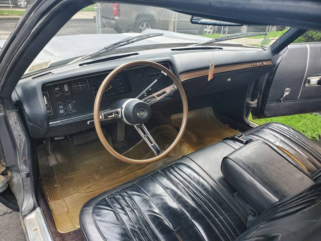

I just did it on my 70 Fury. Easy, just take your time,and put the screws, and nut in separate little containers so you dont mix them up. I also took the time to wash all the hard plastic that I removed. Change any bulbs that are out.

And did you do this with the seat in? And about how many pairs of glasses did you go through?:p
