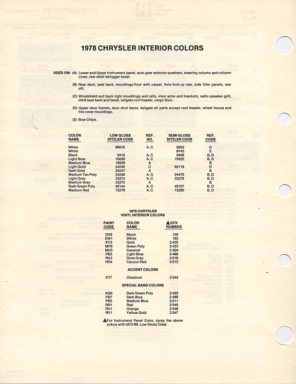

I have encountered this problem for a second time with the dash pad on my 78 NYB fading from blue to what looks like black dirt. I tried scrubbing it with a cleaner on the first dash pad and then discovered it was taking the color off and I believe all of the dash pads start out as being a tan color. Ok, I gave up on that first dash pad and lucked out and found a second dash pad that was in excellent condition. Now the 2nd dash pad is fading and looks like it's black dirt. Has anyone else had problems with Formal dash pads fading? What did you do to fix it? My interior color is PLB3 Blue. Is there some sort of fabric paint I can use to fix it?

SEM Vinyl Coat products do an excellent job... I don't know if there's a direct colour match to your particular blue, but it should be very close. I've had fantastic success over the years - mind you I've only used their Landau Black colour, but from all reports others have similar success.
As in all things paint-wise, prep is key.
Color Coat™ Aerosols Products | SEM Products
Here are some colour chips showing the various hues:
vinyl repair SEM color coat aerosols, trim paint, bumper colors
If you don't mind a different shade of blue, the SEM rattle cans work real well. I did a lot of mine in it and the only issues I've had is where they had been dyed by previous owners. You have to follow the prep to the letter.
