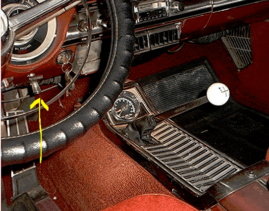

Is your rear fader down loe on the dash to the right of the column? I'm used to seeing either a fader or rear vent in that spot, never seen a car with both.
Here's where mine is.........

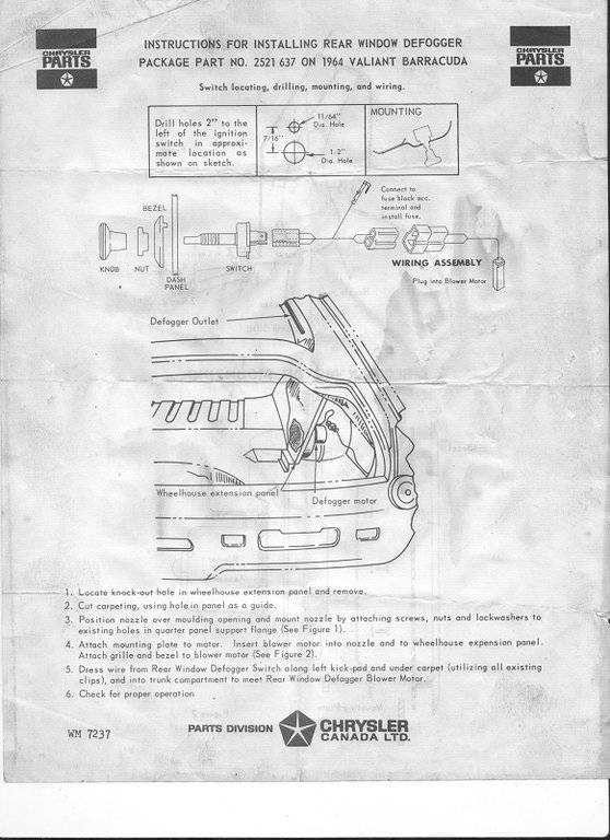

As I understand it, I believe that the rear defogger was a dealer installed accessory for a lot of those cars in 1966. The kit that the dealer used had specific instructions for switch locations. I found a scan of installation instructions for my Barracuda. At least that might give you a direction for what to look for.
And just for laughs, I ran the part number and found this! A little pricey and no mention of the installation sheet, but here ya go... NOS Mopar 1966 C-Body Rear Defog Package | eBay
EDIT: Spotted install sheet in bottom right corner of one of the pics.
Yeah, I saw that one too, that's actually what started me on the hunt for the correct switch. I got one coming from a Dart, might throw one in there too, but then I noticed it looks nothing like the switch in the eBay ad. I have two sets of defoggers from cars from the 70's,one correct switch on the way for my Dart, and the hunt continues for the Polara 500.
