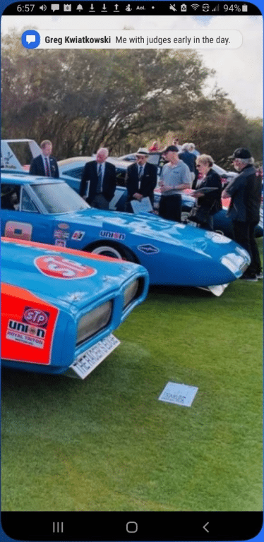

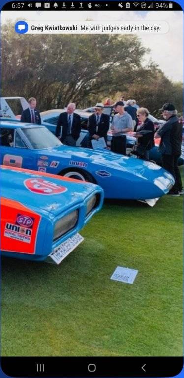

Displayed on the Allpar site:
DC-93 (#88) at Amelia Island show

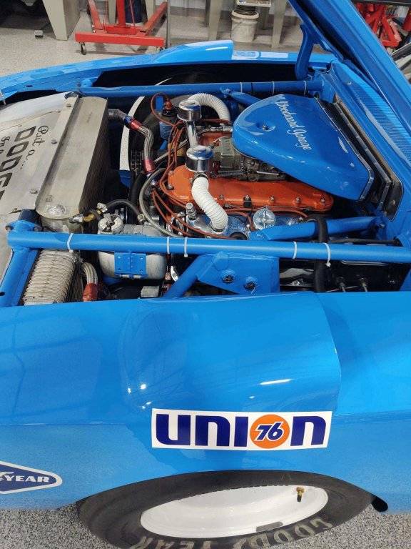

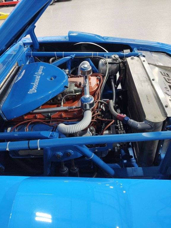

Seems like Petty Blue is a tough color to match..................some nostalgic race cars from the distant past..............................
I used the original left side headlight door cover to use for paint matching.
The 88 is painted exactly the same color as it was originally. It was never exactly “Petty Blue”, but very close.

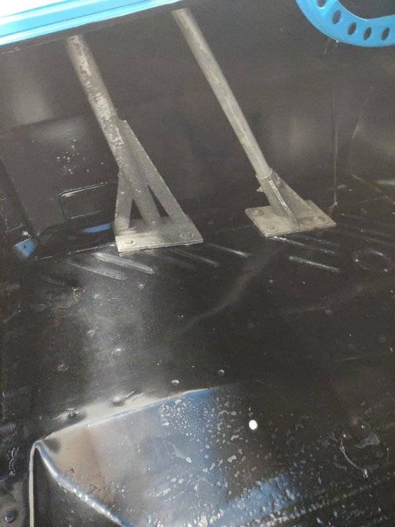

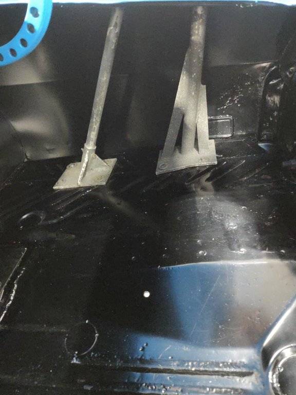

Impressed by how the rollcage is integrated into the unibody across the floors.
That's over the torsion bar support/anchors.
Under the car they remove support to lower the chassis.
To get the strength back, they add support inside.
