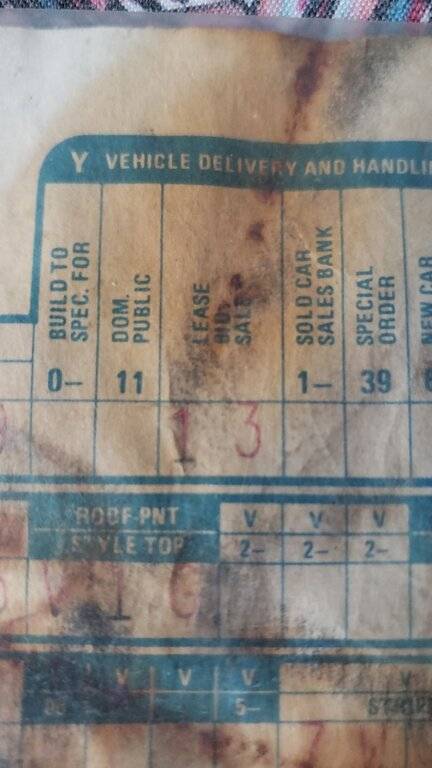

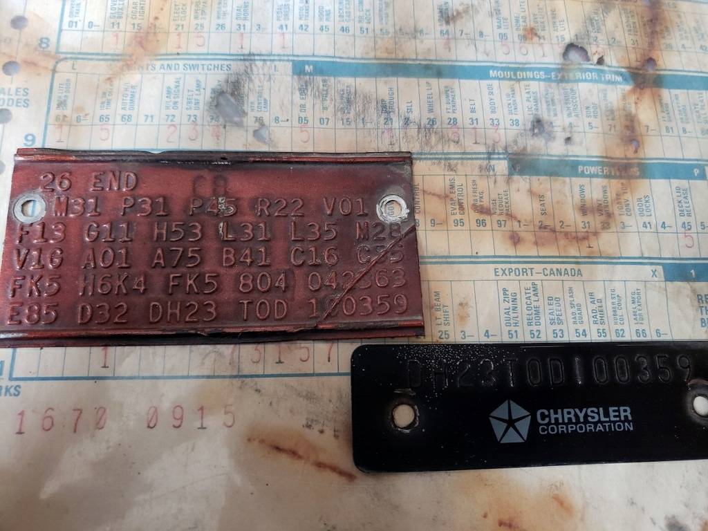

@69CoronetRT is that Y13 code also displayed on the fender tag or just on the broadcast sheet?
As shown above, broadcast sheet, window sticker and other paper work. I don't think I've ever seen it on a fender tag.
That is why I asked, my cursory research didn't say much.Funny how what was thought to be a simple question turned into a more complex answer.
True. And it starts when you purchase.
I used to say I have two...
Like DM27L9D100582, CE23N1C107019 (the 1971 Newport with sunroof that @saforwardlook and I teamed up to get a couple of years ago) has a Y13 code. As @MrMoparCHP noted, the Y13 code is on the build sheet but not on the fender tag.
