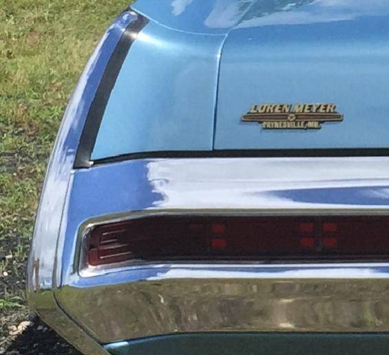

Until now, I have gone clear of cars with "dealer emblems".. but the B3 Imp has one.. and as I never have the pleasure of having to deal with one before now I was wondering, are them babies ever drilled / stud mounted, or just glued.. and should they stay, or should they go?
I almost can't imagine that the dealer would be stupid enough to drill, but then again, "ones never knows with **** sapiens"..
In a way, they are a part of the cars history, but I DON'T like them.. (I know that, because the bigger they are, the less I like them).
I think this one may have to go..!

That one almost looks like a stick-on.
That one does look stuck on. I can see it both ways. If the tag was from the dealer that sold the car new, I'd keep it. Otherwise round file it. Usually the chrome metal dealer tags have been drilled. Put painters tape around it first & then slowly pry it at various corners if you want to remove it. If you see one drop of overspray on the emblem, I'd leave it alone. Unless you are repainting.

It's hard to tell from the picture. I think that's plastic and stuck on.
The way to easily remove one is with dental floss and "saw" it off. Don't try to pry it off.
If it is stud mounted, you'll figure that out pretty fast.
If it is stud mounted, chances are it's a press in type stud where the holes are drilled, then a plastic or metal insert is placed in the hole and the emblem is pressed into the holes. That will have to be gently pried off, but then you will have a couple holes to deal with.
There's a chance it has studs with a metal "nut" holding it on.... You'll be able to see that from inside the trunk. The guy that put it on would have needed to put the nuts on easily.. so they would come off just as easy. Still have to deal with holes though.
Agreed dental floss is the way to go. I usually spray a little WD-40 around it too. It will usually take the glue film off too. That looks glued on to me.

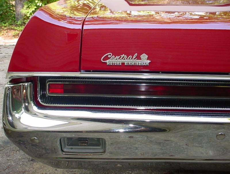

I drilled holes in Jazebelles deck lid to install a NOS dealer emblem. It gets a lot of attention and draws comments, A form of detail often overlooked.
