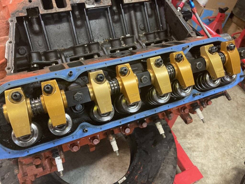

Monday night I finally got my hands on my first engine- a 451 cubic inch Stroker based on a Dodge 400 that he had in his 1966 Charger. Full Crane Cams Gold roller rocker valvetrain, ported and decked 906 heads with new valves and seats and port matched to his Air Gap intake (which he has on his 572 in the Charger), Lunati Voodoo cam and lifters, and 9.5 to 1 compression. And not only did he sell me the engine, he sold me a Torker 383 intake, another Lunati Voodoo cam, lifter, springs, and pushrods, a set of chrome valve covers, and a parts washer! Not bad for $120 for everything.
It does suck that he did the oiling mod for the rocker arms. Hoping I can revert back to factory oiling and still retain those 1.6 ratio rocker arms without having to ruin my vintage valve covers.

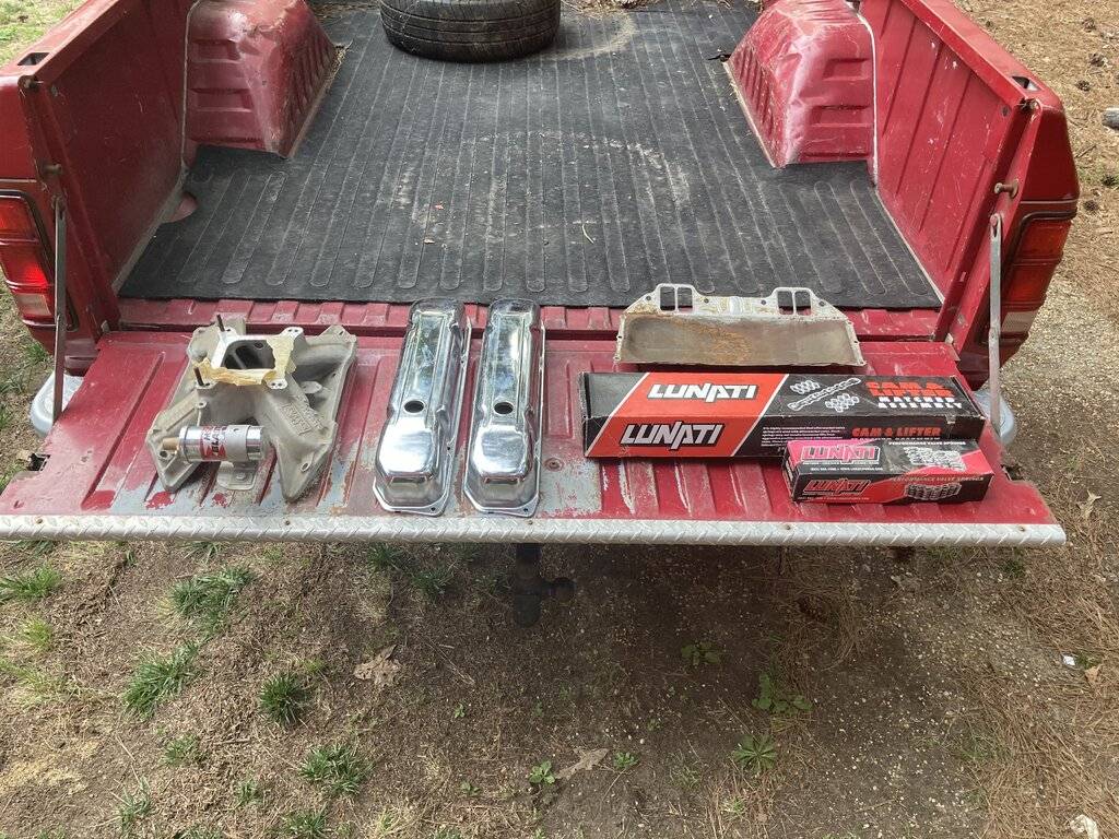

Here's the updated stock pile of goodies that will be complementing those 906 heads on Delmae's 383. The Carter AVS 6125S was rebuild during the quarantine by myself on that exact table there. The valve cover's are off a gentleman's 1969 Charger R/T 440 4bbl and had been sitting on a shelf since the 1990s. He even found the oil breather that was on it while on the Charger. The driver side 2951216 manifold was actually bought off of Joe Bonnette, and the 2806900 from a gentleman in Idaho (still trying to sell the 2843247 manifold that came with it). Only thing missing is the Comp Cam XE268H I have, and may possibly find a air grabber air cleaner to match.

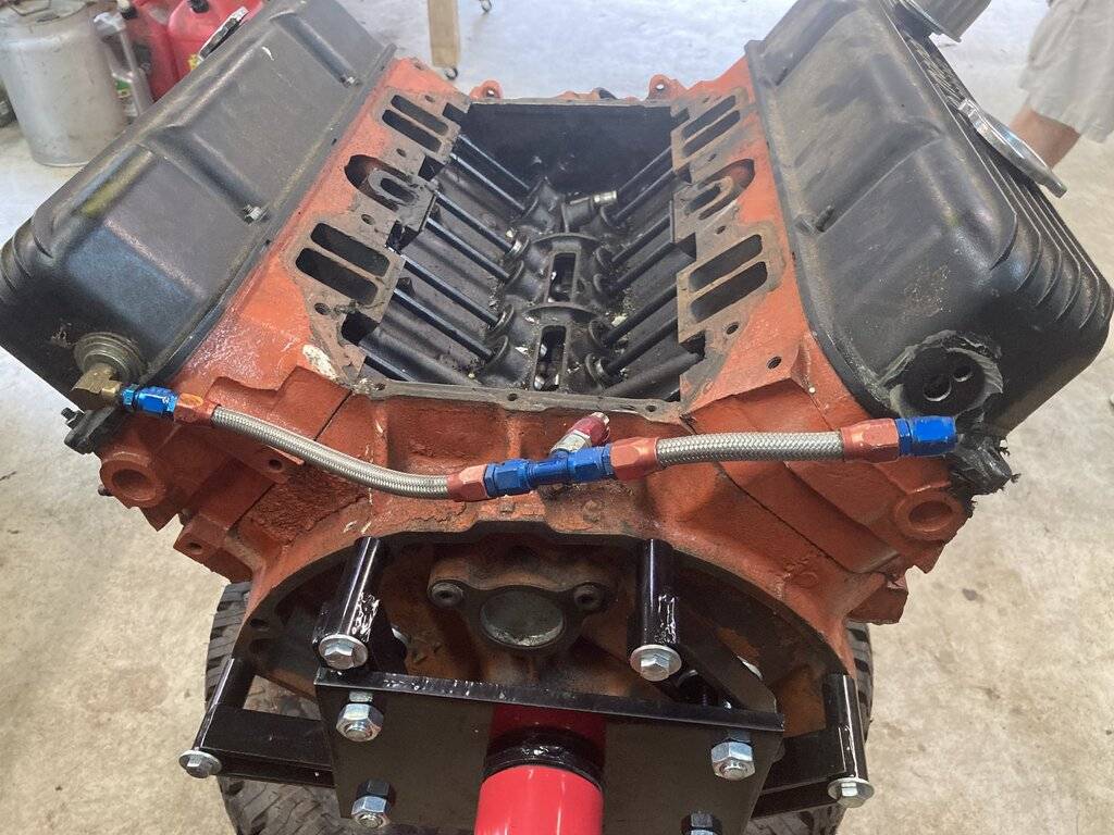

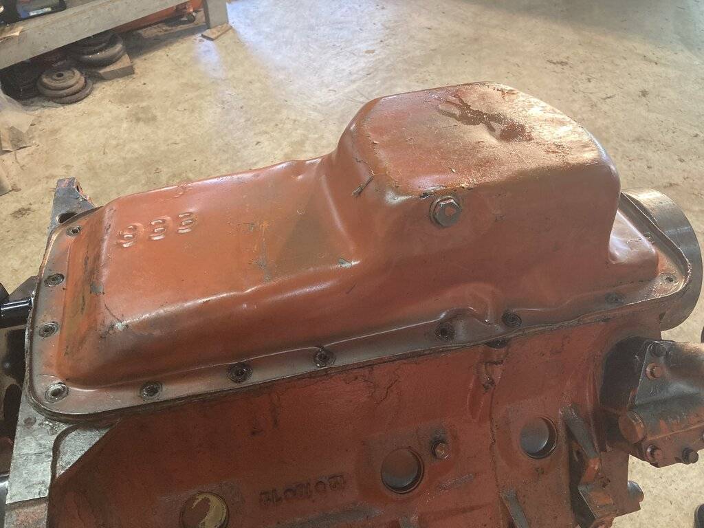

And here is why I stole the engine for the price I did....that’ll buff out, right? I’m eager yet afraid to see what the carnage is. Notice how the oil pan is blown out in the first photo.

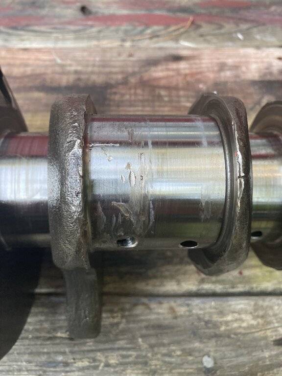

Well $120 is ok for a used set of golds if they didn't get ruined. Cast crank, probably junk run through the whole thing.
That's my plan. I only bought it for the heads, as they are probably worth 10 times that. I may revert to the heavy duty stamped rockers (or find some stamped 1.6 rockers)

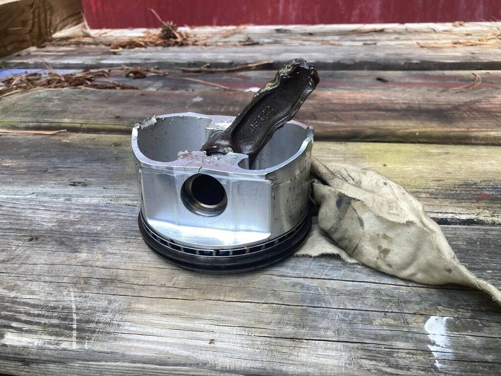

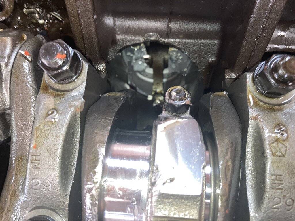

Rod either parted company with the crank and hit the camshaft or the crank broke and took out the lower end of the block. 400 block and Stroker kit are most likely toast. But that was still a good buy for the heads, rockers, and extra parts. Heads have the good valve springs and probably had some port work done.

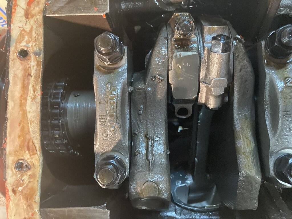

Realized I never made a follow up post on the engine. If a picture is worth a thousand words...just see for yourself!

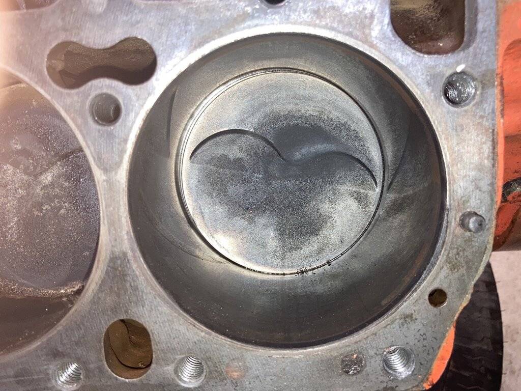

When we first brought it home, the bottom end was completely locked up. Seems like the rod and bearing got lodged inbetween the block and crank and wouldn’t allow us to turn it over. Heads checked out fine and will even be reusing the ARP head bolts. Unfortunately not much else could be salvaged (see cylinder wall) and the 451 block will live the remainder of its life as a flower pot
