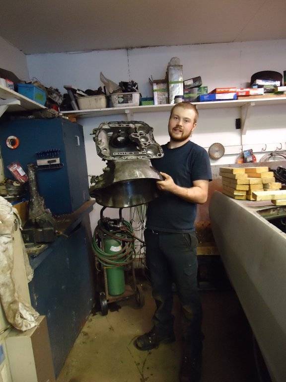

Then this afternoon I tore apart the A727 or TF8 as they are known in the tranny world (Pun intended)................my partner in crime photographed as I took it apart.....I ain't perfect and I'm bound to forget where things came from...........what i found was less then pleasant......It needs rebuilt......found clutch material in the pan and inside everything......kickdown band isn't bad, forward band is eff'd........pan isn't much better......took a straightedge to it.....holy **** it's about as straight as a wet noodle.......oh well.........turns out it's not even the original, it's a '74 727......
^see those ain't my feet.......
