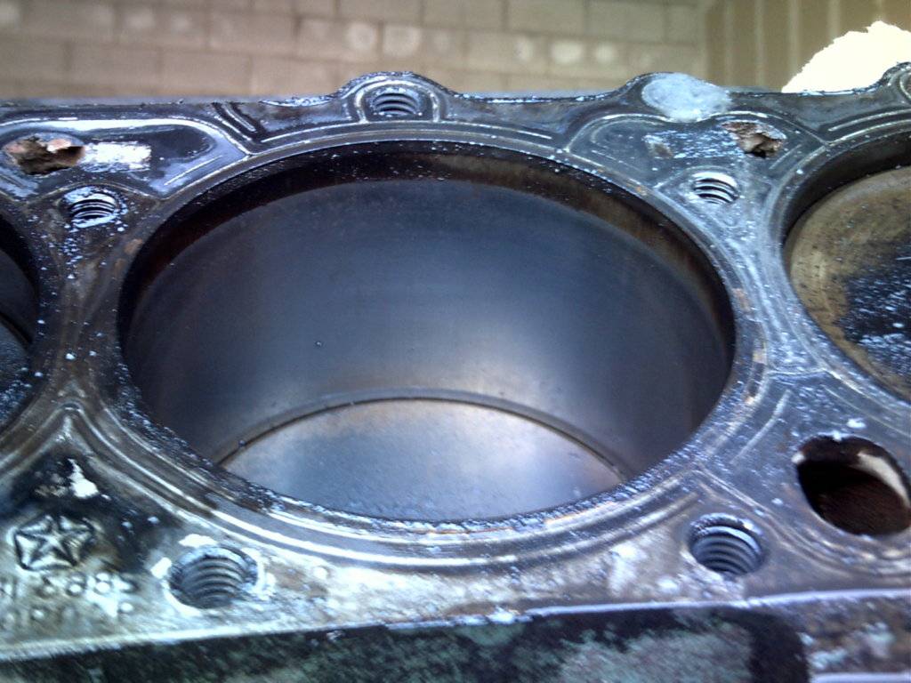

I'm refreshing a 140,000 mile non-hipo 383 4-bbl for my 1969 Newport convertible. (Not the original 90,000 mile 383 2-bbl engine, which is seized after losing all coolant from a rusted original lower hose spring clamp. It will require re-boring, pistons, etc...). I've cleaned everything up. Measured the bores. Maximum bore wear is at top of cyl. #4, with a measurement of 4.2534" along with minimum bore wear of 4.2508" at bottom, for a total taper of 0.0026". These numbers don't indicate a need for a re-bore. All cylinder bores and pistons look great! Gotta love Mopar blocks for their longevity!
My question is, what piston ring size is appropriate? Standard or an available 0.005" oversize? Any advantage to using the oversize rings with the standard size pistons after honing? Or is the standard piston ring size sufficient for good cylinder sealing given the wear and after any honing?

The .005 would let you tune the ring end gap to your own spec when the std may have a little extra clearance. Make sure to check gap either way. If you are measuring the bore that precisely you probably are good
Get a good fine ball hone for the cyl bore and just deglaze the walls. They follow the bore better and dont try to actually hone the shape of the bore.
Enjoy the build. There is few thrills equal to the first fire on a rebuild to me.
While the numbers tend to look good for "no unusual wear", are the bores round? Looks like the pistons are still in their holes? The older service manuals used to mention using a "ridge reamer" to get rid of that upper ridge in the cylinder walls just to get the pistons out.
What you're seeing is just the top of the cylinder bore, but with no vertical marks, probably no scoring on the piston skirts.
Consider that the bore taper is a wear issue, although it can still be "in specs", but that when the engine was originally built, there was no bore taper.

you are going to need to remove the ridge at the top of the cylinder no matter what rings you end up with. personally i would try the +5 thousandths and file to fit. make sure to check your end gap at various depths of the bore. also make sure your ring lands are perfectly clean. the slightest amount of carbon build up or grit can break your new rings. the bores wear on the outside more due to the V engines design, so you will never achieve a great seal without an overbore. you should be able to perk it up a little though.
Prob would have been better to leave the original stuff in there if it was a place holder. But since it's apart now...
You need a ridge reamer to remove the step at the top. Leaving it in place may damage the new rings. High likelihood IMO, but sometimes you can get away with not removing it.
Get std bore rings and just put them in. The ring gap itself is not that critical, expecially when your bores are not round and straight. The .005 sets as noted are for file-to-fit builds where the bores are straight and round (because they were machined that way).

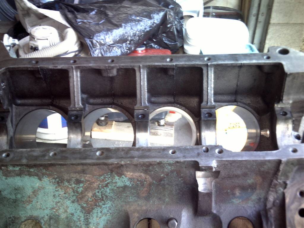

Thanks for all the advice guys! I plan on removing the ridges with my ridge reamer. I'm using the original pistons (all cleaned up, including ring lands) and just putting new rings, bearings, cam, lifters and timing set in bottom end. I've cleaned all but the crank and oil pick-up/pan assembly. Everything looked great! The only failure I noted was the first camshaft bearing was completely cracked. Not sure what caused it, but it stayed intact until I removed the camshaft. I'll have my local machine shop press in the new camshaft bearings.
The cylinder taper varied from 0.0009 to the 0.0026 on #4, most between 0.001 and 0.002, pretty minimal if you ask me. It sounds like standard ring size will work just fine, but I'll probably go with chrome-moly rings. I will be checking ring gaps and plastigauge the crank journals.
