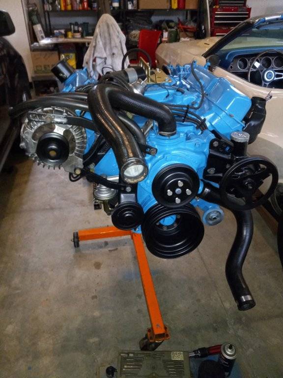

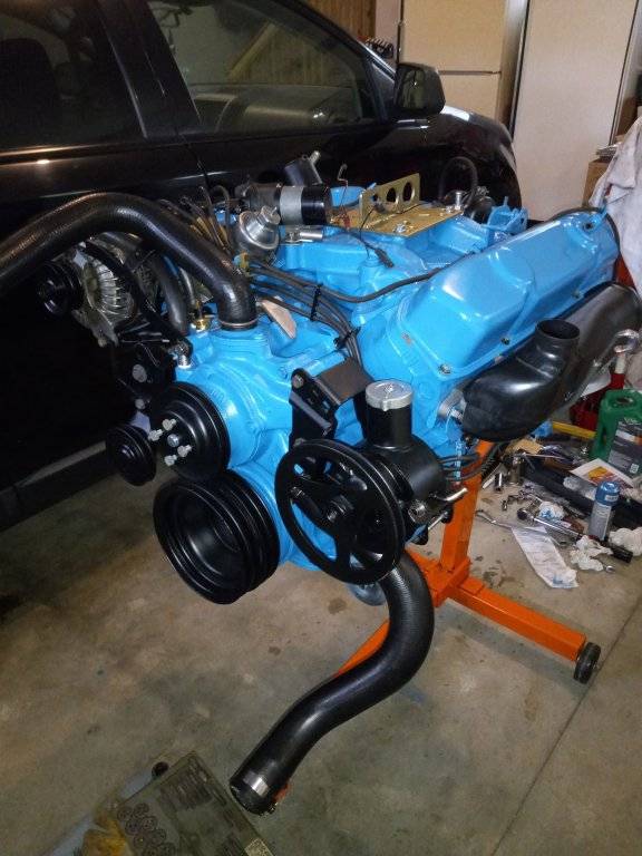

I decided to do a full teardown and rebuild even though the engine only had 45K miles on it. So, I replaced all gaskets and seals, timing gears and chain, camshaft bearings, rod and crank bearings, and piston rings. I kept everything standard size as the crank and camshaft were good and the cylinders just needed a light honing. Also had a valve job on the heads as two exhaust valve seats were badly worn.
Current state:
After machine work:
Looks great. Will be a nice running 440.
Is that upper rad hose used?
Upper radiator hose is original, lower is an earlier replacement which I inserted the anti-collapse spring from the original hose. So, both hoses have been used on this vehicle previously. I do have a replacement upper for when the original fails.
