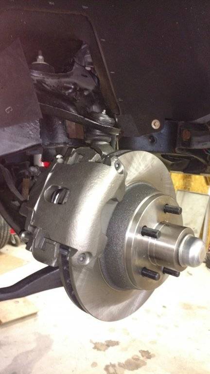

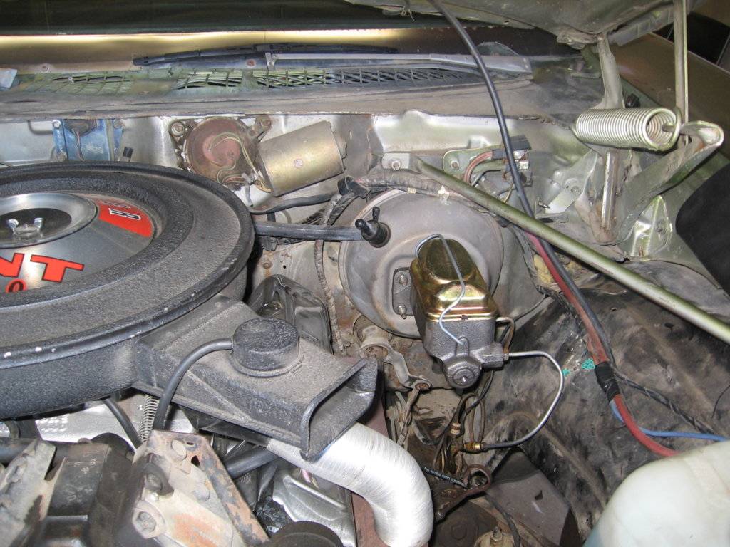

Nice convertible! Regarding the hydraulic balance: You should use a proportioning valve from a disc / drum car.

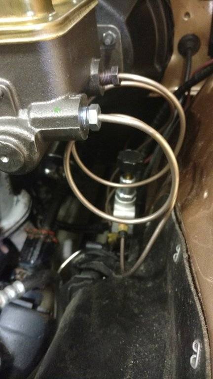

I originally used one, but had issues so dumped it in the trash and now run the front circuit straight off the master cylinder, rear circuit I run a manually adjustable pressure valve. Works great!
I pulled one off of a disk-brake New Yorker that was in a junkyard. Works well and have had no problems.

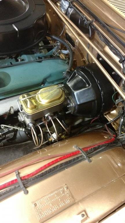

You need a new distribution block if you don't already have a dual master. I added an adjustable proportion valve and could set it perfect for the rear drums. Very happy with the set up.

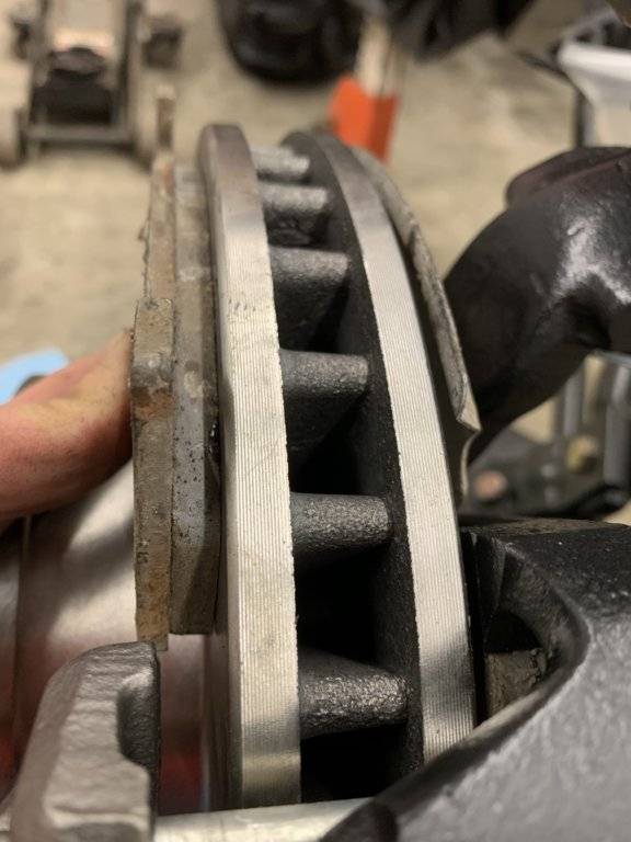

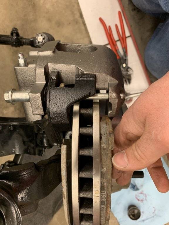

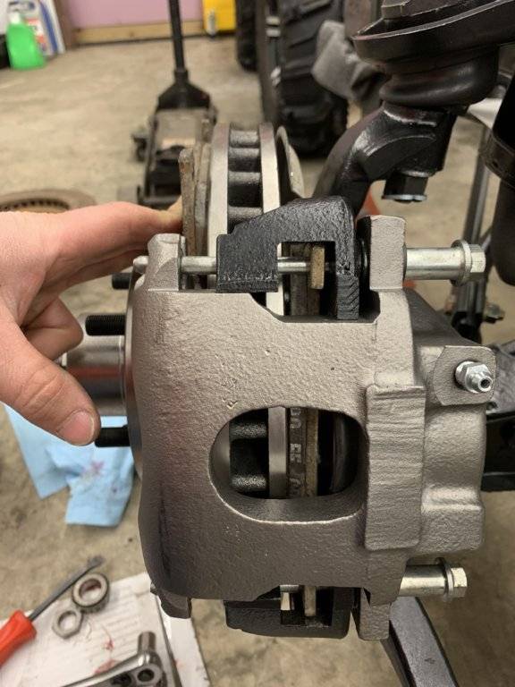

I am converting my 1967 Sport Furys front drum brakes to disc. I have installed 73 disc spindles, bearings, dust seal, new rotors pads and calipers. new parts were ordered for a 1973 Fury everything went together fine until I went to put the pads in the outer pad will not fit and I can not figure out why. Has anyone else run into this problem? can anyone see something I am missing? am I using the wrong calipers? I have to wait until Monday to go get my cores back to see if they measure different than the ones I replaced them with.
I did the same swap 10 yrs ago, didn't have an issue so the suggestion from one reader that the parts are wrong out of the box (b body vs c body) sounds very plausible. I did swap left to right the spindles, which put my calipers at the front instead of back and it's worked fine with no issues. I just shortened the soft brake lines, which I had made in braided stainless, not very expensive surprisingly.
