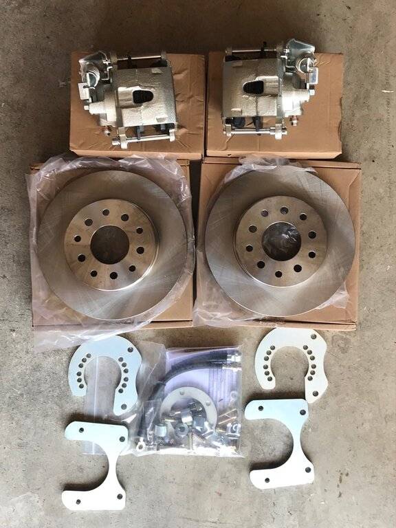

I have the kit currently on the floor of my garage for the rear brakes. I bought it through Summit Racing. I have not installed it yet, but should have it in the car in hopefully the next few weeks or month? I'll let you know my thoughts once it's in. The kit I have requires a 15" wheel (which Alvah already had).

This is the rear kit I got. If I were converting the front from drum to disk I would look for replacement MOPAR parts or Wilwoods. I already had front disks so I just put on new Raybestos pads and rotors from Rock Auto.

That is the point I was trying to make. I know these are off the shelf rotors, calipers, and pads, but I'd rather have a choice to purchase them anywhere. Everything came in a generic white box, the calipers were labeled "Mustang caliper", but I'd just prefer they give a vehicle year, make, and manufacturer for future replacement parts.

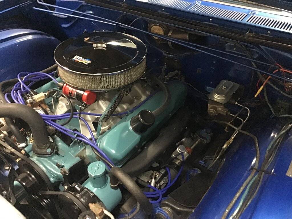

Thanks guys for all your input, I would probably just go with the manual brakes on it but I thought they would work a lot better ? I put new drums and all the hardware on the front and new hardware on the rear and had all 4 drums turned , I was surprised the new drums on the front were out of round. I put a new dual mc on it and adjusted the brakes probably a little tight and bleed them several times but they just feel hard when depressed? If I go with a kit I have 15” wheels on it.
I would also like to ask someone if I try to source mopar parts what years and models will fit my 65 fury ? With a dual mc and power booster do I have to source a different brake pedal?
I did a similar thing since the booster is made out of unobtanium. The hard brake pedal was due to the lines at the master cylinder being swapped. The front brakes must be connected to the front port on the master cylinder.
