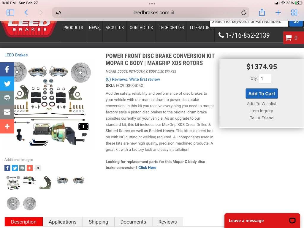

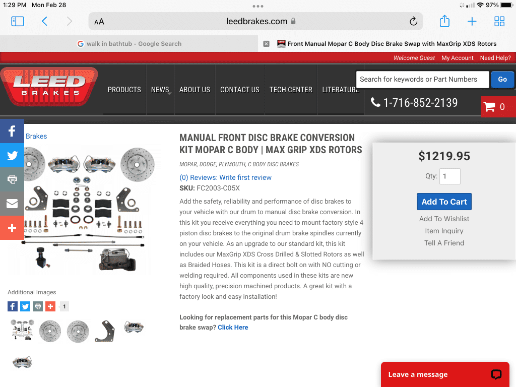

I am thinking about a manual to disc conversion , I see a kit from Leeds I might go with it’s a manual to disc w/o booster do any of you think this will work ok ? Or should I go with the PB booster kit ? I will post these two kits any advice is appreciated.
Manual discs on a C-Body are not going to give you much of an increase in braking power. The C-Body is just too heavy, that is why the factory setups were power assisted. My advice would be to try and find a factory disc setup from a donor car and have the booster and calipers rebuilt. This will be a lot cheaper than the after market conversion and it will be a match performance wise to the C-Body design. What year car are you working on as this makes a big difference on which conversions will work.

These questions come up all the time and often they are after buying one of these expensive kits. From what I've seen, the conversion using factory parts is cheaper and, as long as you source the right parts, just about guaranteed to fit without any drama.

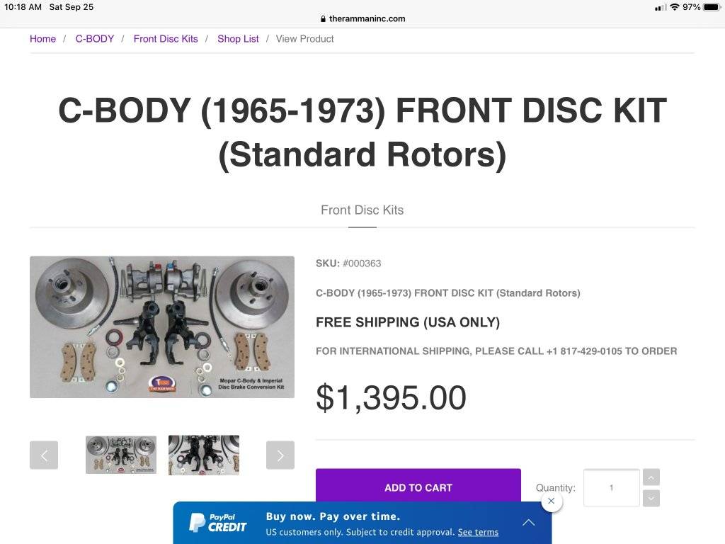

Thanks guys for your input , the car is a 65 fury lll with manual drum brakes. The other kit I was considering is from the ram man with spindles but I would need a booster and pb swing peddle.
You better read up about the ram man, his (resold from other outfits) millions of wrong parts in his "kits", and his lack of knowledge and service....
Comments from people that want to strangle him are all over For C Bodies Only and
For B Bodies Only.....mopar Joe 65.... you need to get off that road......
His Listing (in very small print) is "C" Body and Imperial ---- "C" Body is 5 x 4 1/2 ,
Imperial is 5 x 5 ---
Different Bolt Pattern / Wheel won't even mount / You do the math .....
