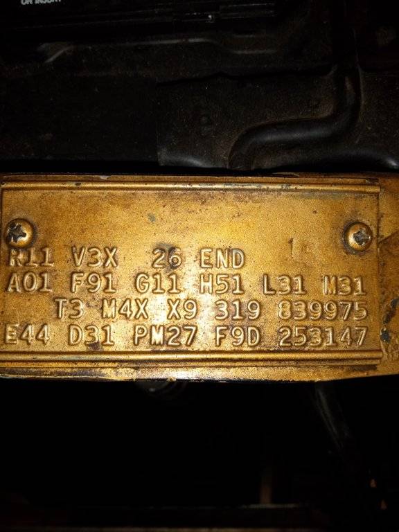

Any chance the fender tag is still there? If so, a B51 stamp would show power brakes.

Does this help at all? The first letter under that screw on the upper left is "R".

BTW - the R11 on the fendertag is likely for the radio.
