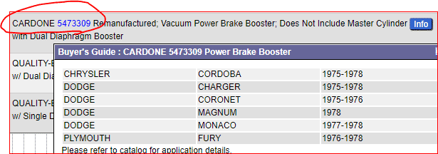

This disc brake booster also fits a 69 with slight modifications to mounting plate (make hole bigger). Also will likely interfere with column shift. Fits my floor shift fine.
1976 PLYMOUTH FURY 6.6L 400cid V8 Power Brake Booster | RockAuto
