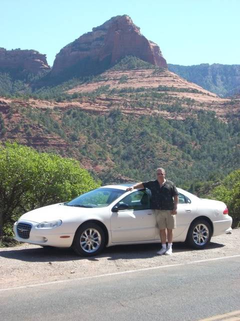

Third piece of advice: Plan a south-western vacation around buying a car. Not only for the salt/rust, but because the table-smooth roads don't beat the hell out of everything else. I do this for anything I plan to own long term, and 5 years later my LHS still feels nicer than anything I could buy in Michigan.

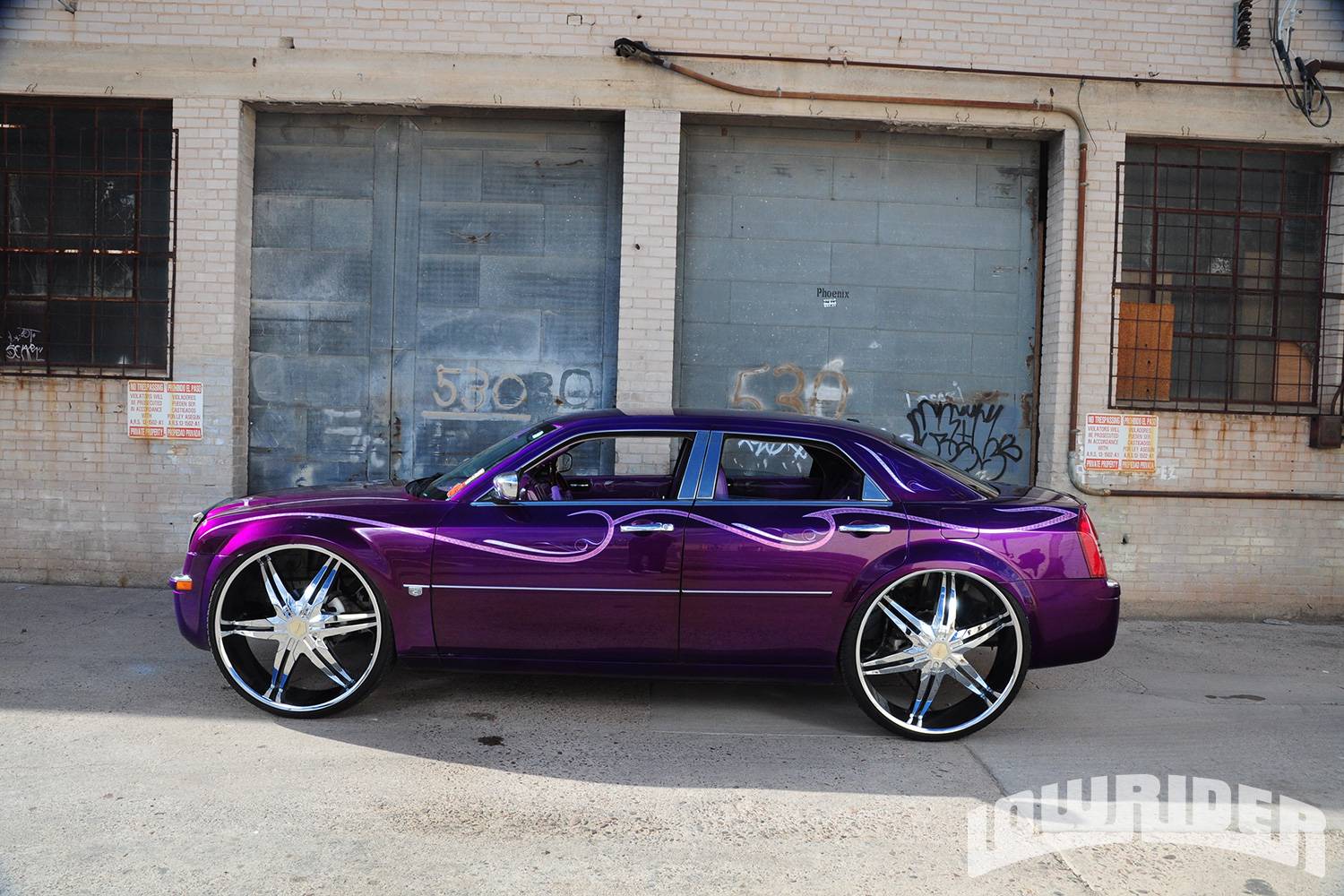

This is the pnly problem Ive ever seen from them
And I cant stand it when I see it. ...otherwise Ive always heard positive things about them
