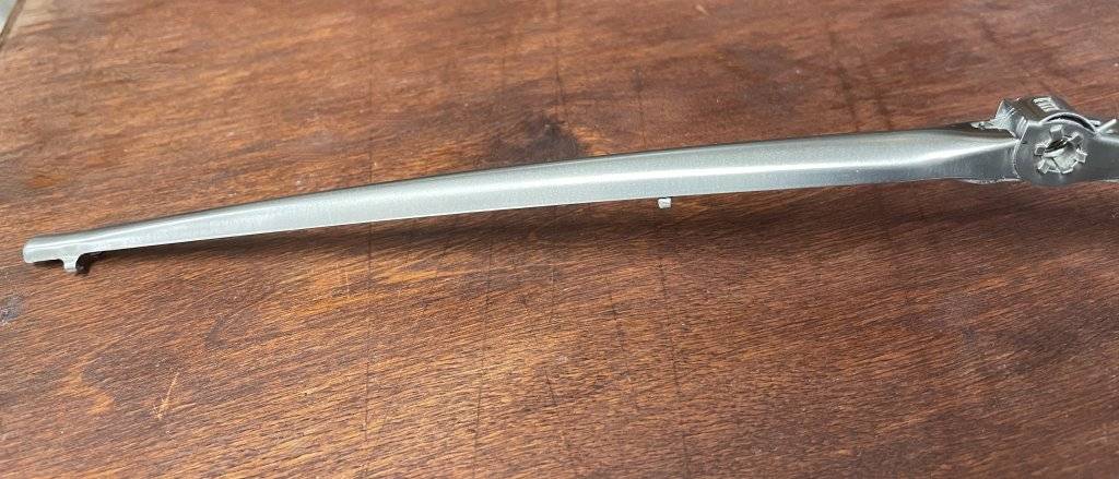

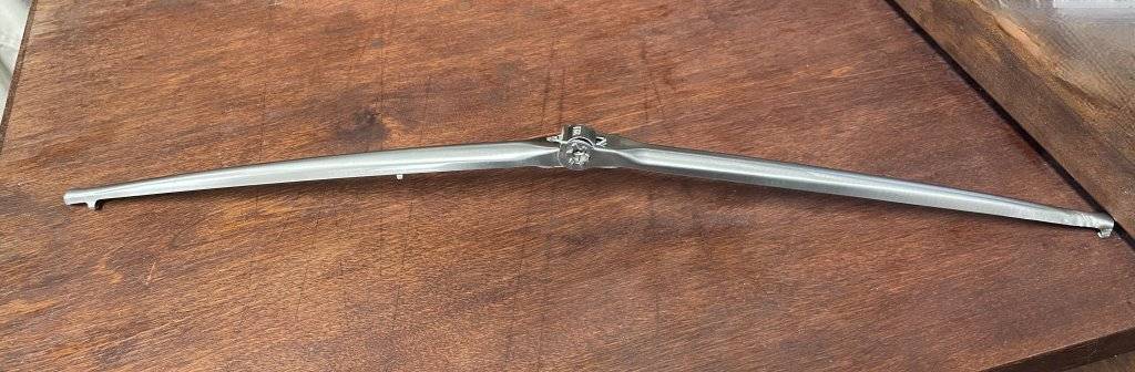

UPDATE on the Trico Classic wiper failure.........
Here's the latest on the Trico Classic wiper failure on my '65 New Yorker...

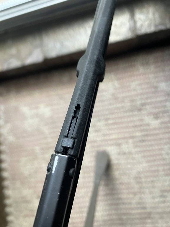

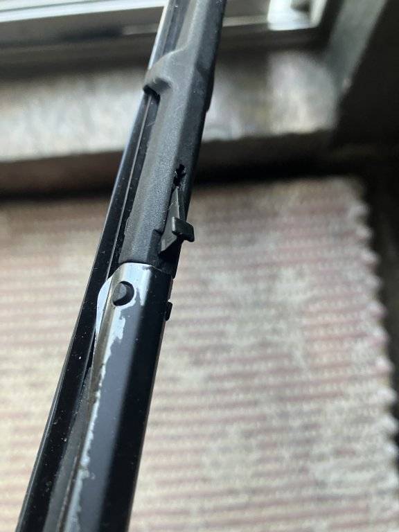

I did not like the flaking paint on my wipers. So I removed it and did a clear coat. I am satisfied.
